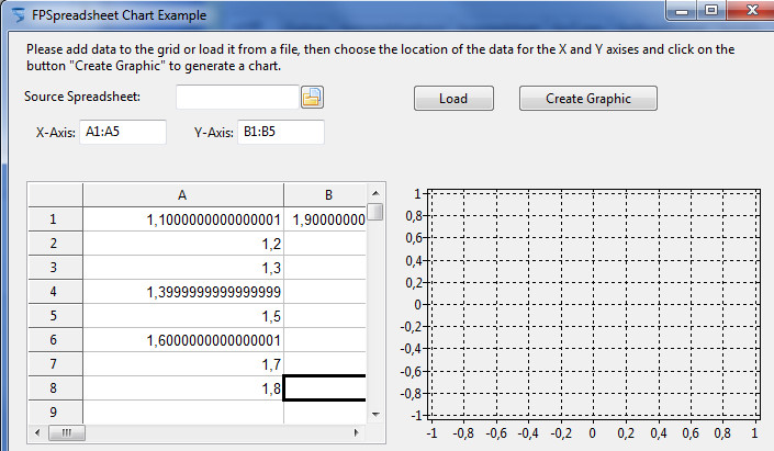

The example in directory "codeocean/fpspreadsheet/sample/fpschart" generates the error described above. it is necessary to specify that this error was not present with version CT 5.2.
Number in cell and formatting 10 years 7 months ago #8973
  • carmelo peri
  • carmelo peri's Avatar Topic Author
I attach a picture to explain the problem.

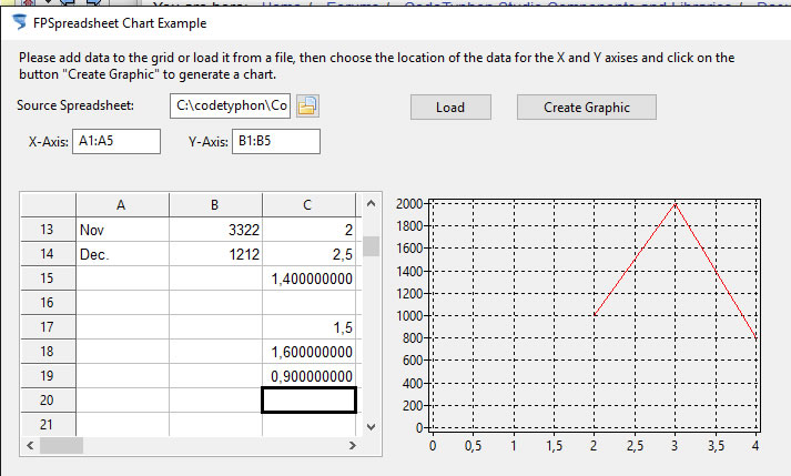

Number in cell and formatting 10 years 7 months ago #8974
I think all are OK
or
I can't see the problem

Sir,
You did not find the problem in example or believes that the operation is correct ?
why it changes only the numbers 1.1, 1.4, 1.6, 1.9?
I accidentally make a wrong setting?
