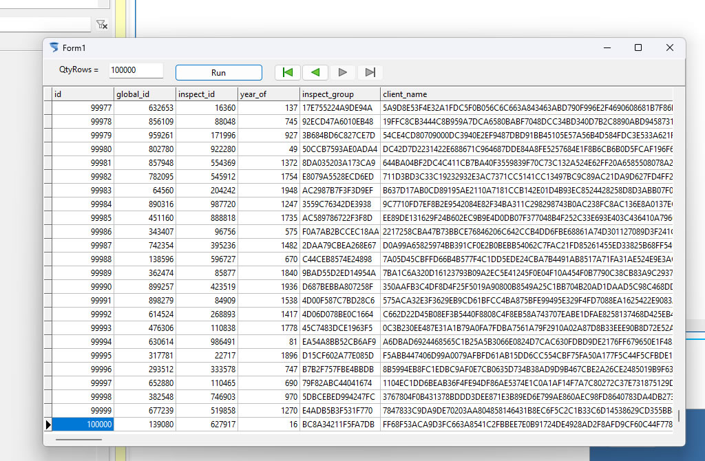

Excessive memory consumption by the TSQLQuery.Last positioning method to the end of a fairly large SQLite table.
A small program for behavior research are attached. Set the number of rows and click Run, a table with
test data is generated(see Source_sql folder) and displayed for clarity. If I now initiate TSQLQuery.Last with DBNavigator, then
if the value is QtyRows=200000 on my computer with 32 gigabytes of memory, it will be exhausted within a few seconds and
the application will crash(see Screenshot_errors folder).
Same behavior for CT8.6, CT8.7 on Debian 12 and on Windows 10 (VirtualBox).
