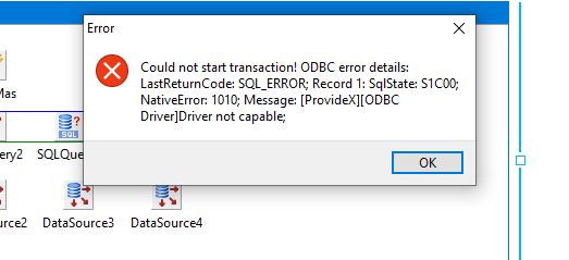

Hello I started a project witch i wanna to connect mas90 and make some queries to extract or validate information, But odbc send a meeesage driver is not capable so i contact to support of PVX them sad the problem is on my odbc, is 64 bits and PVX driver i of mas90  is 32 bits, how i can change to odbc32 bits...

The rule is:
64bit project=>64bit odbc=>mas90 64bit
32bit project=>32bit odbc=>mas90 32bit
You can NOT do these:
64bit project=>64bit odbc=>mas90 32bit
64bit project=>32bit odbc=>mas90 32bit

Ok well what mean i need to start a project python 32 bits and  use odbc32 bits, how i can download 32 bits python.....
