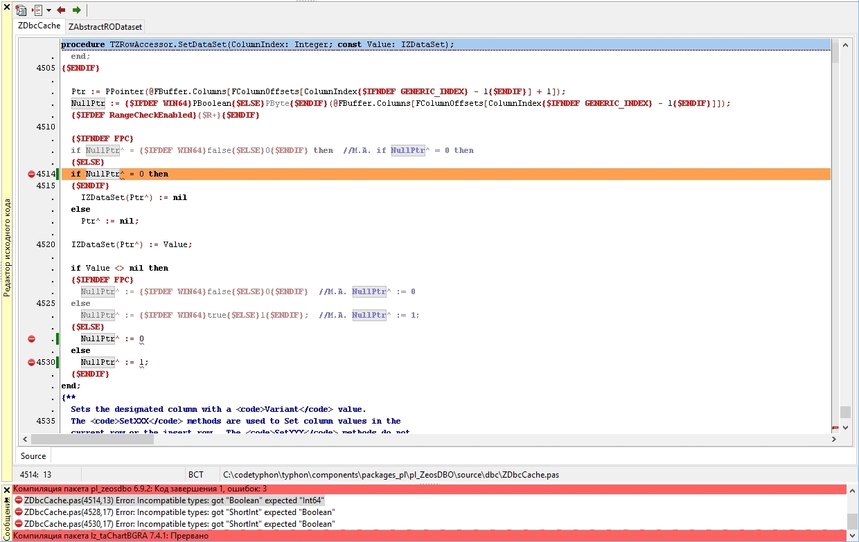

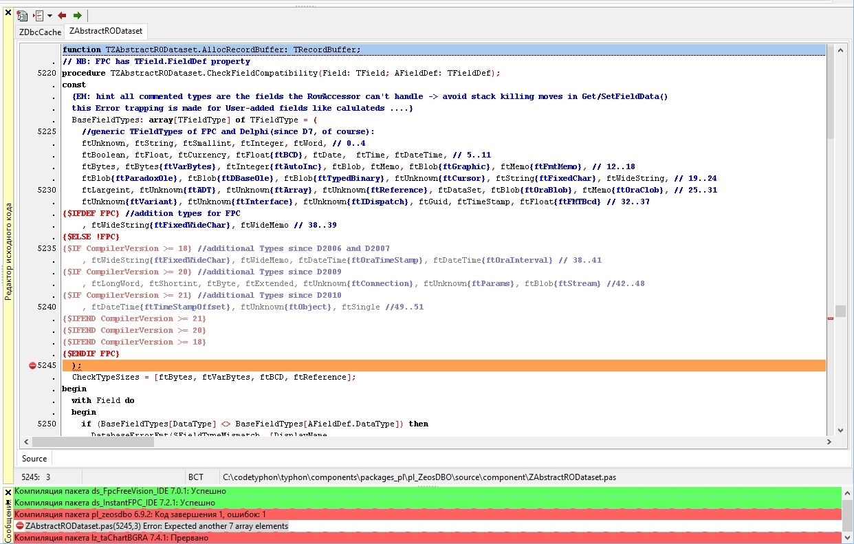

Thank you. But these packages are not relevant for me. When I try to install pl ZeosDBO 6.90 I get the following error messages:

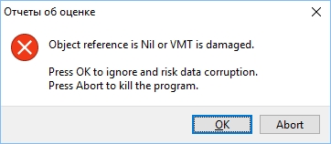

Thank you. After installing and compiling the program, I get the following message:

More info for the program ?

Thanks a lot. The program is quite large, so it is inappropriate to send it all. I'll look for exactly where the failure occurs. If I can't do it, I'll ask for help again.

Thank you so much! Everything works fine. The problem was in the types of fields - tzsmallintfield (remained from version 7.80). Replaced with Tsmallintfield - everything worked.
Thank you very much for your work!
