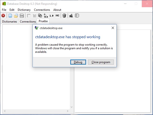

Hi there!
New to CT, but worked a lot in Delphi, so the style of coding is not a mistery to me..., I connected to Firebird (piece of cake) and Postgres (simple as can be), but I couldn't connect to MS SQL Server 2014 or any other version.
Can you provide me with a tutorial or step-by-step or something to allow me to connect? Working on Win 10-64, MSSQLS 2014, CT 6.3.

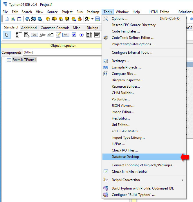

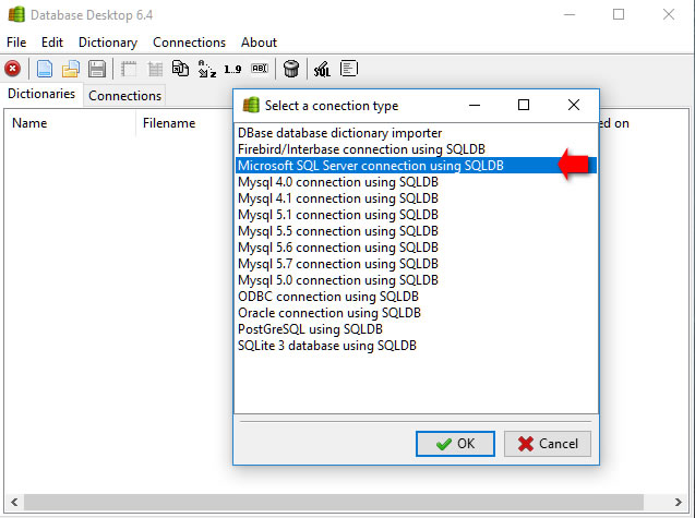

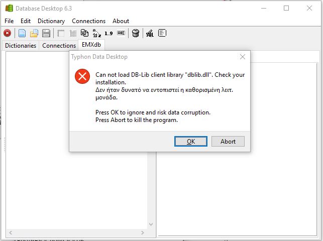

Hello Mr. Sternas,
Using CT 6.3 final, Database Desktop crashes both on 32-bit and 64-bit of TyphonIDE.
Crash occurs with either option (New Dictionary, new connection etc).
Best Regards,
Manos S. Pappas

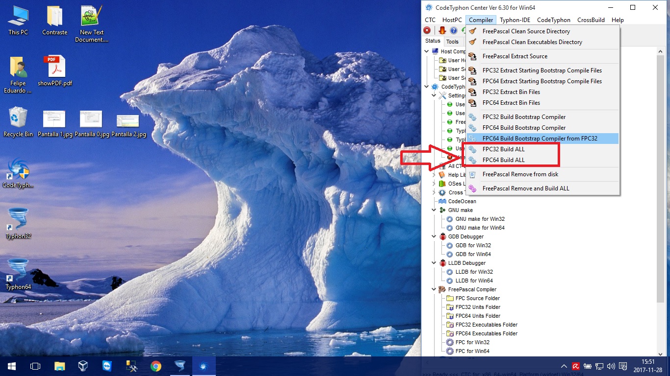

if your PC have dblib.dll all are OK
if your PC have ntwdblib.dll then go to
C:\codetyphon\fpcsrc\packages\dblib\src\dblib.pp and set
in line 32: {$DEFINE ntwdblib}
and Rebuild FPCXX

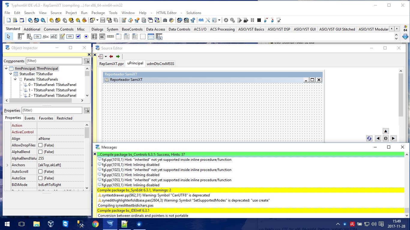

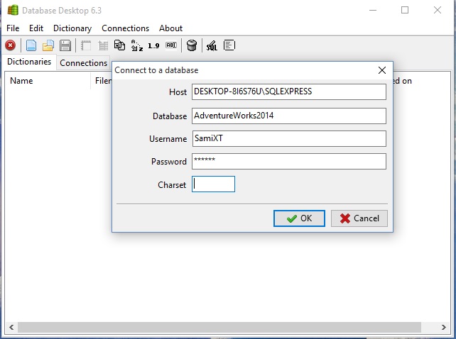

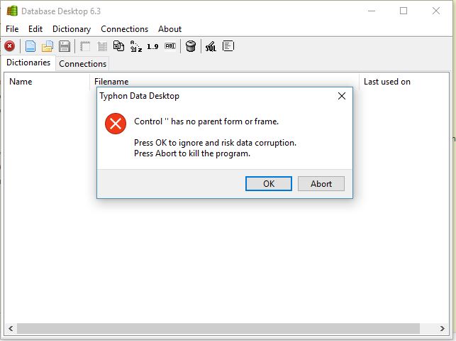

Tried the solution, but as reported above, had an exception. Right now applied the solution and rebuilding the tools and Big IDE (I assume thats the correct building), when its done, I'll try and will be reporting any pending issue. Thanks in advance.

Thank you for your answer.
Unfortunately, the Database Desktop tool crashes when trying to create a new dictionary.
Best Regards,
Manos S. Pappas

Sternas Stefanos wrote: More info Sir
-did you test "dblib.dll" or "ntwdblib.dll" ?
-Typhon32 or Typhon64 ?
Thank you sir.
- Tried ntwdblib.dll, compiled fine and is detected right. The access violation also appears when the tool is compiled for dblib.dll.
- Both Typhon32 and Typhon64 expose the problem.
Using CT 6.30 final.
Best Regards,
Manos S. Pappas

CodeTyphon connecting to MS SQL Server 2014 8 years 9 months ago #11122
  • Felipe Eduardo Ortiz López
  • Felipe Eduardo Ortiz López's Avatar Topic Author
  • PASCAL programmers do it recursively...
  • Posts: 9
Sternas Stefanos wrote: Thanks
we working in a new version of ctdatadesktop
more soon...
Well, so my news had became old...
Done everything as requested (changin the file, rebuilding) but no effect, still having the exception...
And I need to connect my application to MS SQL Server. How 'soon' is 'more soon'?

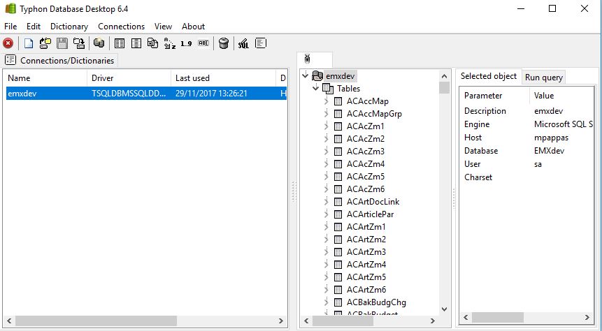

CodeTyphon connecting to MS SQL Server 2014 8 years 9 months ago #11126
  • Manos S. Pappas
  • Manos S. Pappas's Avatar
  • Posts: 69
Sternas Stefanos wrote: Soon is "LAB soon" :)
Please try the new (BETA) ctdatadesktop
and your help please....
Replaced the CT6.30 one inside the source typhon package, rebuilt everything and it works great both 32 and 64 bit.
Thank you very much :)
