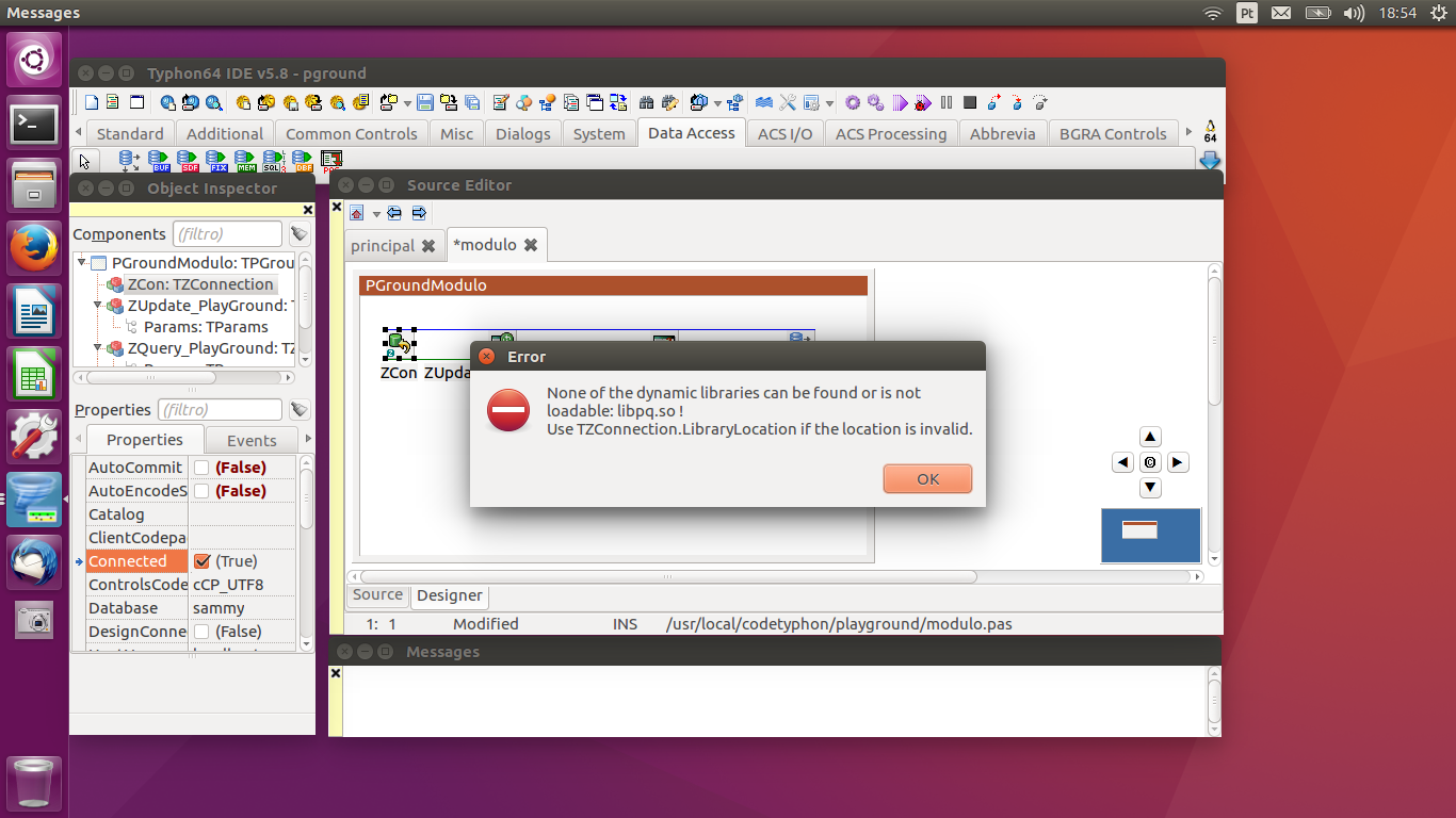

I have a problem here when i put in try connect on my postgres database 9.4.
And I follow this steps TZConnection Component in the Typhon64 v5.8 on Ubuntu 16.04 :
AutoCommit - true
Database - summy
HostName - localhost
Name - dbsummy
Password - mypassword
Protocol - postgresql-9
TransactionIsolation - tiReadCommitted
User - postgres
So, when i set Connect = True i have a error:
"None of the dynamic libraries can be found or is not loadable: libpq.so !
Use TZConnection.LibraryLocation if the location is invalid."
Can you help me?

libpq.so is part of Ubuntu PostgreSQL Package libpq-dev info
Try to install PostgreSQL library,
in a terminal:
sudo apt-get install libpq-dev

Now I have CT running back in the rails again.
I ran "sudo apt-get install libpq-dev" and the problem was solved.
