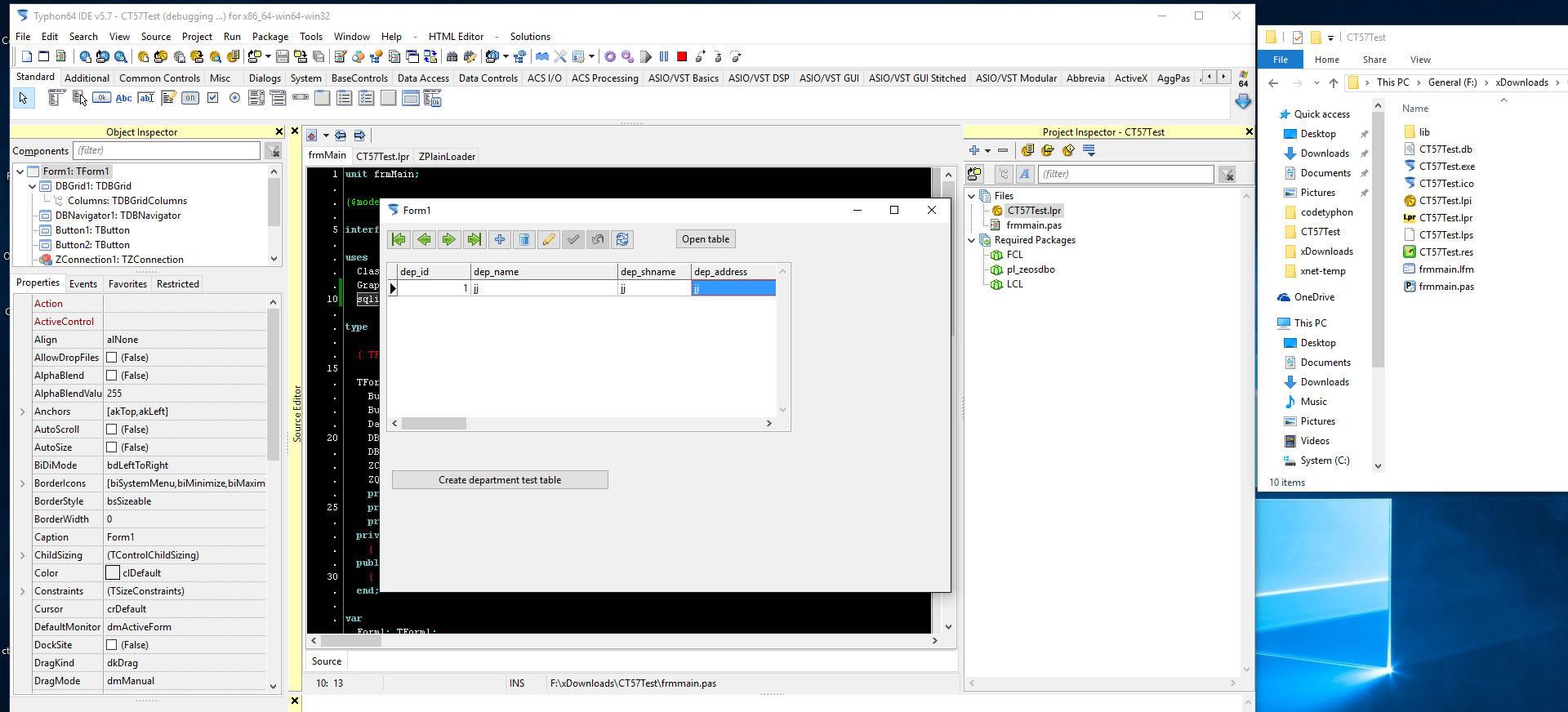

Good morning @Javor
ALL are OK
on Windows 10 Pro Typhon64
and on Fedora 23 Typhon64
I make some small changes to test project

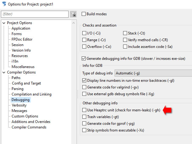

ZeOS DBO with PostgreSQL memory leak :( 10 years 8 months ago #9110
console app or not, my suggestion is to use project debug options
"heaptrc" procedure is Typhon-IDE debugging procedure, NOT project procedure.
If you make "heaptrc" part of your project, you must know and the CT debugging working model
and this is NOT simple...

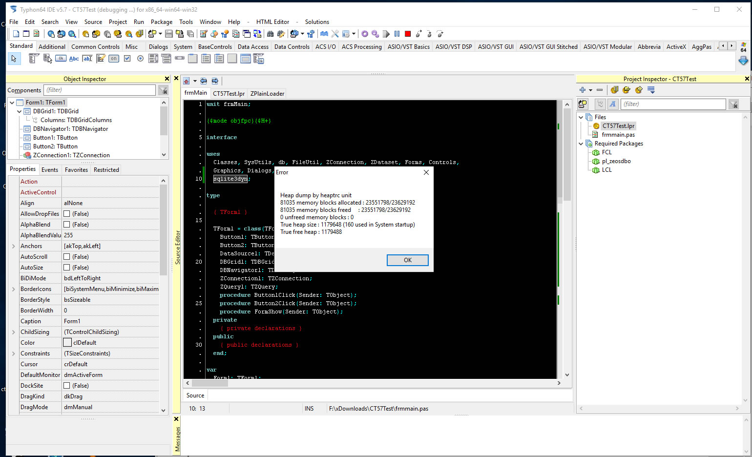

I'm glad to anaunce with the comming CT5.7 all leaks are gone:
Heap dump by heaptrc unit
8966285 memory blocks allocated : 56353887/82534432
8966284 memory blocks freed : 56352863/82533408
1 unfreed memory blocks : 1024
True heap size : 1245184
True free heap : 1243872
Should be : 1244096
Call trace for block $07E7DBF8 size 1024
$00442D0E
$0044315C
$00451234
$00452FA6
$007D3189 ZTESTBUGCOMPCORE_$$_init, line 1906 of D:/Developer/Delphi XE/Components/ZEOS/test/bugreport/ZTestBugCompCore.pas
$00410D14
Just my added 1024 bytes to proof leaks. :) :)
