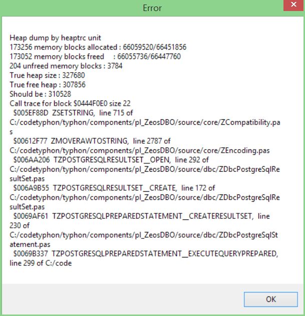

A set of TZConnection and TZQuery dropped on a form, connect to Postgre, ZQuery performs a single select on a non-empty table.
Turn on heap-trc before compiling project and look at the result.
Here's my report in the image attached.

Current ZeosDBO is in huge trouble with FPC3.x gen. Actually i can't say why. The line the "Javor" reports was a simply System.SetString(). And indeed millions of memory leaks are reported if i'm trying to use CT 5.5/6.
BUT it's not a problem of Zeos, rolling back to a deprecated 2.7/6 eveything is fine. Since a week i'm trying to make simple project for the FPC core to raise a ticket.... but i fail. Inbetween i've the idea there is soemthing broken using global functions + !!! Interfaces !!!
So the report of Javor is correct but NOT a ZeosDBO issue.. I need some help in this domain.
The differences between Zeos-7.1 and Zeos-7.2 is:
In 7.1 series everything was a String or UnicodeString which means for the Unicode IDE's like D2009+ or FPC in delpiunicode mode it was a nop. Same types. So i've been spitting this processing to faster RawByteString or UnicodeString (according driver dependencies). But the codepage agnostic idea of FPC3+ seems to be broken for some unknown reasons.
Michael, ZeosDevTeam

please stay professional. I didn't say you'r report is wrong. I'd say the line you've reported is inside ZCore function ZSetString was a system.SetString. Indeed i've been tracking the issue replacing SetString by SetLength ... the issue is gone. Therefore i was forced to introduce a define {$WITH_SETSTRING_MEMLEAK_BUG} for FPC >= 3.0 which reduces the memory leaks a loads.
It's not my intention to say you did something or your report is wrong nope, the more i'm informing CT there is a huge problem i actually am not able to find the origin. And the issue was introduced since ??? (sorry for my absence) i did upgrade to CT 5.4/5. Since i was failing to find out what's wrong with this revision i simply was waiting for the next CT version. Horray CT5.6 was released .. sadly i've to announce the weired issue continues.
That's why i wrote: I need help. And that's why i pointed the differences out.: 7.2 uses the correct RawByteString whereas 7.1 uses the String in loads of the functions. 7.2 is loads faster intitially because of this but as long the weired memory-leaks do continue... broken arrow. There is not one memoryleak with FPC2.6 or any Delphi release but millions (if i run my ZTestAll -> SVN) which happen since a for me unknown version of FPC3.x.

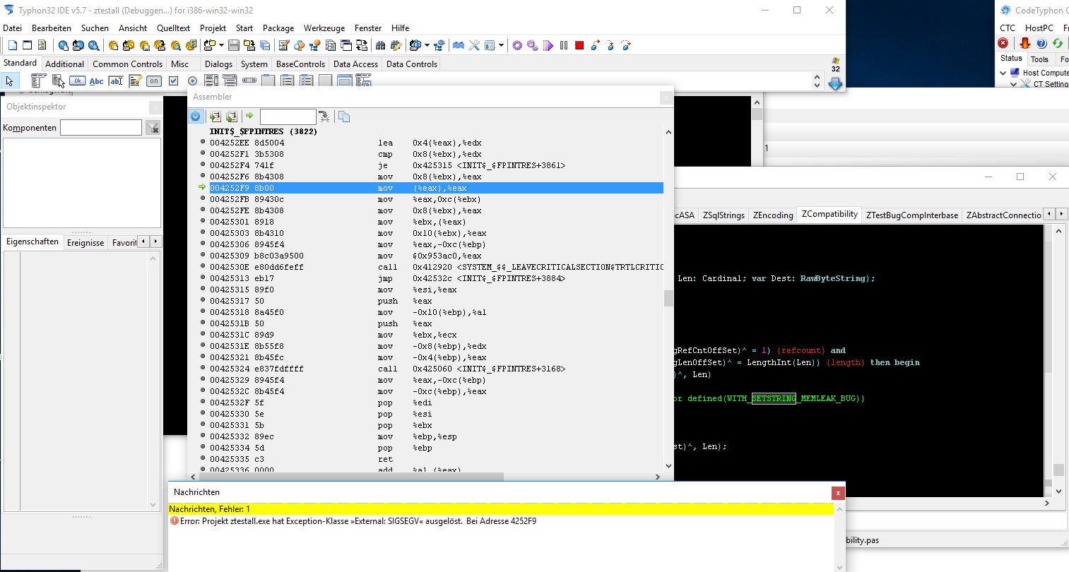

First approach to run the ZeosTests did fail with a sigsev see attached picture. :angry: Note MDeams (Zeos project-manager) did also report same error last days. AFAIK he uses the FPCUP, i just use CT.
This error happens just on startup. I can't set a breakpoint somwhere. :blink:
Trying to make a little tast app now and see what happens...

New findings, Sir
The sigsev occours on using the heaptrc unit. Comment the unit in the project and you're able to get it running.
Which than means ... i can't judge if something has been changed inbetween :S
Maybe you can find out what's going on? Is there a difference because of the huge memorymanager refactorings you guys did on ct5.7?
Edit: Nope i don't think so else MDeams wouldn't report same sigsev -> Next FPC issue :whistle:
