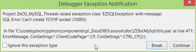

Here's the example project as an attachment and an exception if mysql connection is NOT initialized in the main thread first. So far I think, I'll move my project to either MariaDB or PostgreSQL. Last one works for me in another big project. When I have more time, I'll dig deeper into this, but sadly deadline for current project are close, so...
Regarding the Exception (see comments in the example project), it occurs at
InternalCreate;
in ZDbcConnection, line 818. Sorry I can't provide more info and make debuggers life easier, but currently I have only this as info and no time to trace...
P.S. Situation with other databases is as following:
MariaDB 10: almost the same. I say almost, because the same code sometimes works, sometimes an exception is raised: "SQL Error: unknown MySQL server host 127.0.0.1 10093". Again no chance of working if lib is not initialized in the main thread. Sad.
PostgreSQL: works like a charm. It works even if you make 25 threads simultaneously open a table and read from it. It's all the same code. No need to init anything in the main thread, nor sync whatever.
Think I'll move my project to PostgreSQL so far.

THIS is no offence now. But my previous statment was just clear and right.
I made some researches for you which you should review because MySQL is NOT threadsafe on open a connection:
this costs me hours just to support you
Some routines 7.2 calls before a real connect happens and they are strictly required for embedded setup or user defined server setups:
dev.mysql.com/doc/refman/5.7/en/mysql-library-init.html
dev.mysql.com/doc/refman/5.7/en/mysql-server-init.html <--deprecated
dev.mysql.com/doc/refman/5.7/en/mysql-init.html
and also the the mysql_real_connect isn't threadsafe:
bugs.mysql.com/bug.php?id=79510
All in one i just did correct your example and added some notes. It's not a question of how many threads you're running or if libmysql has been loaded on startup. Nope you just have to connect before the thread is going async. This is clearly documented by mysql. Running several threads isn't the proplem but you need to open the connection on creating the thread before going asynced in background.
Since 7.2 dynloading different libs with multiple setups are supported. This was broken on 7.1. which strictly did load the libs.
What do you think?
Last edit: by Michael Hiergeist.

Hi Javor,
it might be possible entering a TCriticalSection resolves all the issued MySQL connect stuff. IMHO it's user task to setup the critical-sections for MySQL and build a theading pool. I can't change what MySQL is.. Fetching/Executing works well with MySQL + mutithread environment. Of couse all other drivers zeos does support are threadsafe. Just the MySQL issues in this domain. But it's documented.. and not a blame for Zeos as you stated before.
Cheers, Michael
Bug in ZeOS DBO 10 years 6 months ago #9170
  • Michael Hiergeist
  • Michael Hiergeist's Avatar
  • Posts: 24
  • Thank you received: 7
Hi Javor, Starnas Sir,
i took a moment and added the TCriticalSection to the TMySQLConnection.Connect. Your template works now without any problems. And without open a connection in the Main-Thread of course.
Current Trunk R3865 contains the fix and loads more FPC3 fixes.
Have fun!
