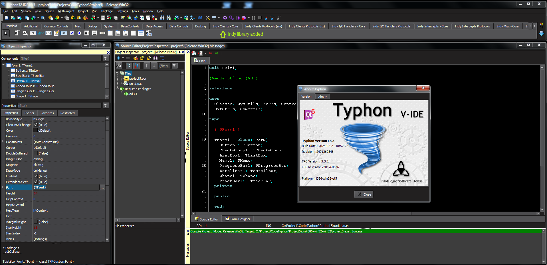

I try to figure out why CT doesn't install the entire components pallete for QT5 and Win64 or Win32 installation and CTCenter claims to have built BigIDE.
The situation concerns a fresh new installation of CT v8.30. Of course, after CT installation is completed, we can later install additional components, but this is quite time-consuming. Unfortunately, not all components (like BGRA) want to install and are looking for units related to the *nix environment like X, XUtil, XLib. Can you try this on your LAB?

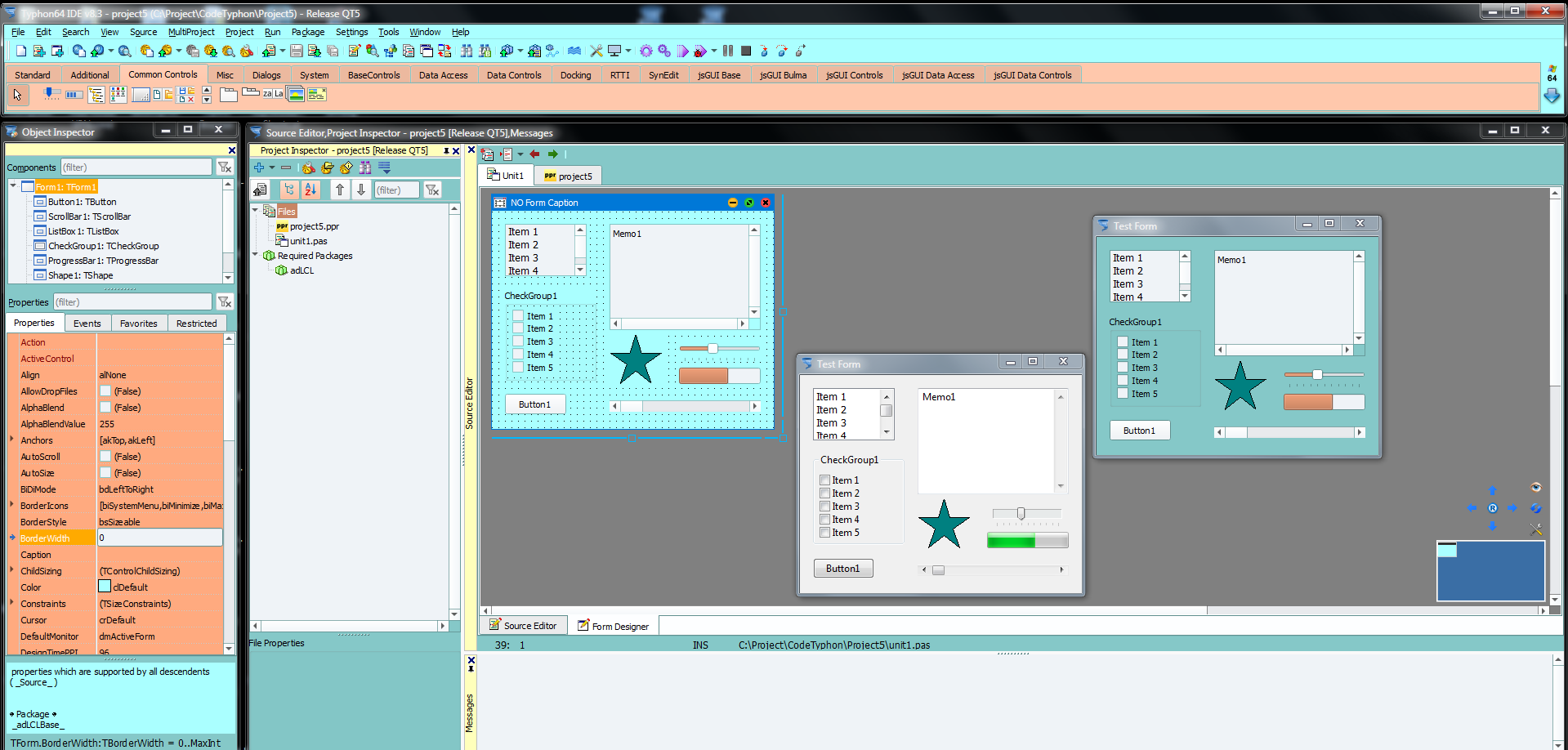

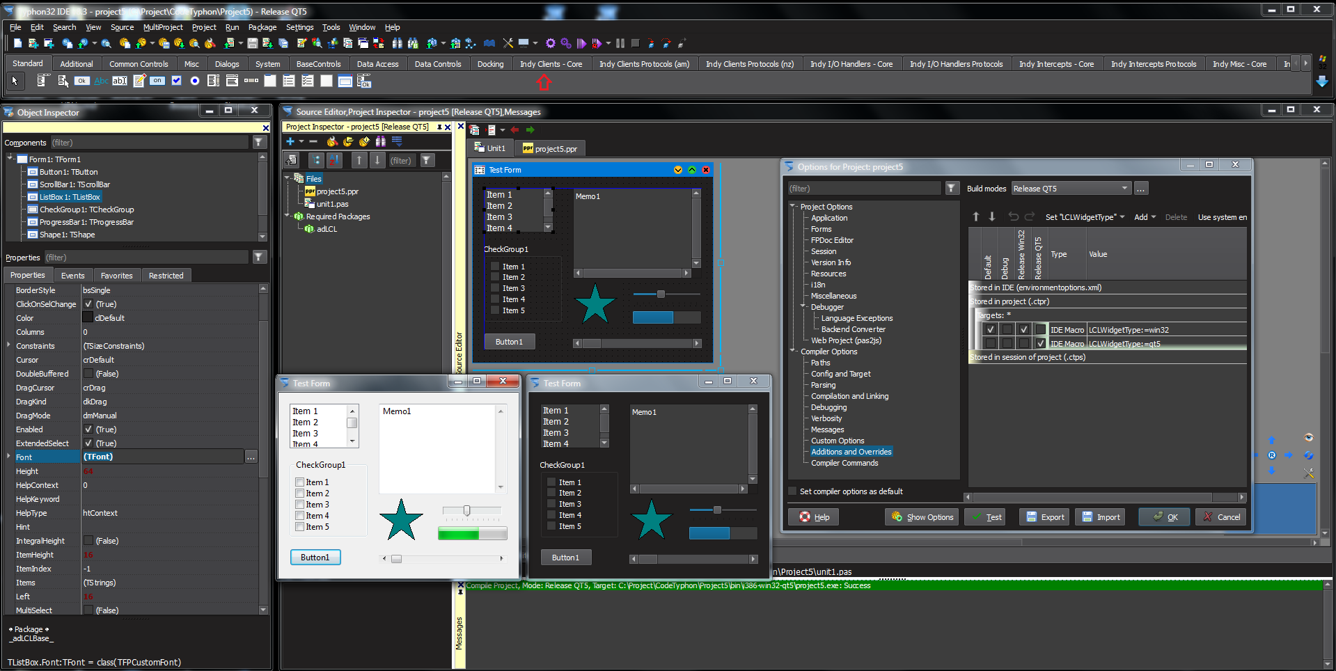

CT based on QT5 for Win64 or Win32 looks quite good (Win7x64 on screens) and maybe could be an interesting alternative to Win7/Win8 users since "Dark Style" is only available for Windows 10/11. Additionally, thanks to QT we can personalize our colors and build QT5 and Win32 interface native applications at the same time.
Now I'll try with QT6...
