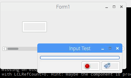

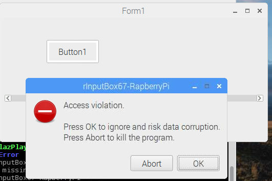

This is my code.
var str : String;
str := InputBox('Input Test', 'Type your string!', 'Test');
ShowMessage(str);
I tried arm-linux-RapberryPi compiler when I made the environment. And this is output.
I tried arm-linux compiler when I made the environment. And this is the output.
Any suggestions?

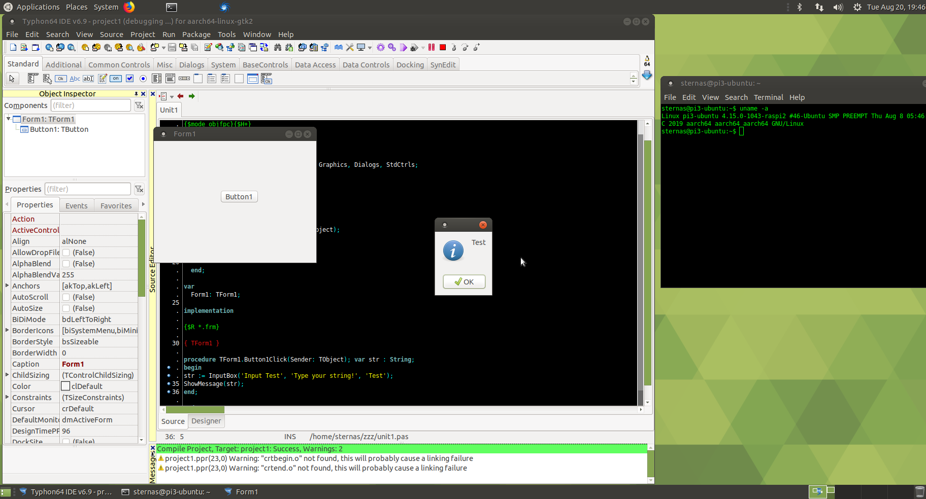

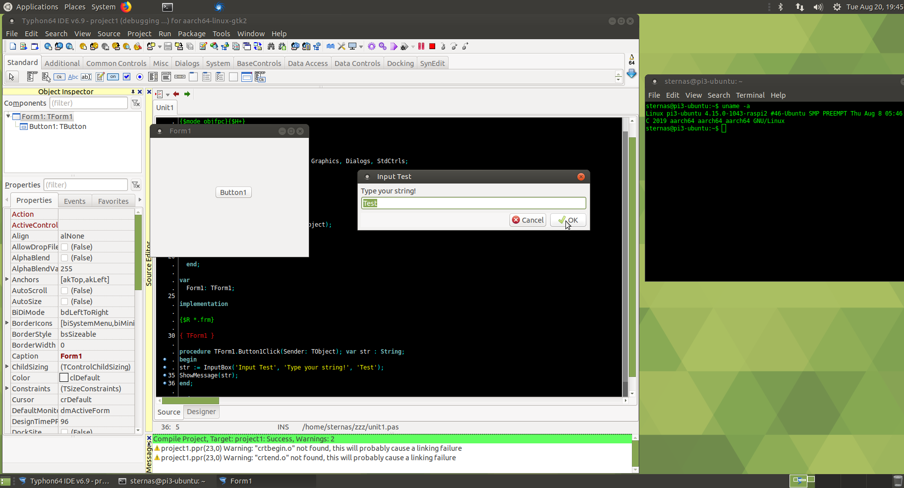

[bug report] Calling 'InputBox' in Raspberry pi 1 raises exception error. 7 years 2 months ago #13625
we test on Pi3 with Ubuntu-Mate-arm64
and LAB CodeTyphon 6.90
without any problem.
[bug report] Calling 'InputBox' in Raspberry pi 1 raises exception error. 7 years 2 months ago #13626
  • chulwoong
  • chulwoong's Avatar Topic Author
  • Posts: 15
It looks like older raspberry-pi is not supported.
Good to know and I will upgrade my system to the raspberry-pi3.
Thanks.
