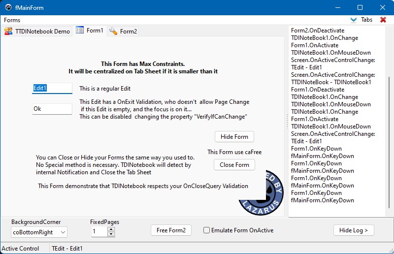

New components TDINotebook (Lika a MDI in TPageControl->TabSheet 3 years 11 months ago #17334
  • Augusto Angelim
  • Augusto Angelim's Avatar Topic Author
  • Posts: 4
Like RX MID!
This works SO FINE on Windows and Raspberry Pi 3b+ and Ubuntu!
Last edit: by Augusto Angelim.
New components TDINotebook (Lika a MDI in TPageControl->TabSheet 3 years 11 months ago #17335
We will test and add this comp to LAB CT
The following user(s) said Thank You: Augusto Angelim
