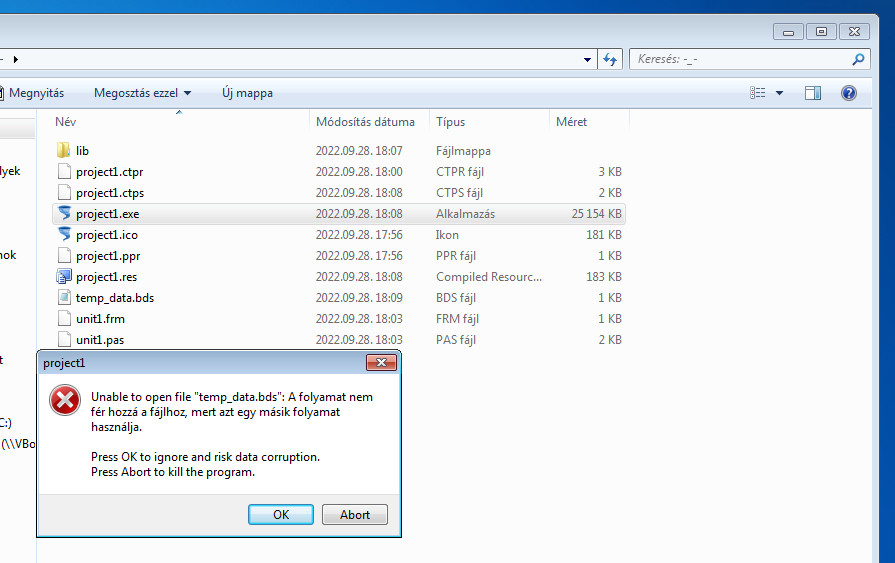

Hi!
Has the BufDataset unit changed since version 7.5?
7.6 etc. versions, it works in a different way, because it writes the contents of the BufDataset to the disk, but it cannot read it back! But it worked fine in version 7.5!
const
  BUFFERFAJLNEV = 'tempbufadatok.bds';
var
  Form1: TForm1;
  BufDataSet1: TBufDataset;
  szamlalo:integer;
  szamlalo:= 0;
  BufDataSet1 := TBufDataset.Create(nil);
  BufDataSet1.FileName:= BUFFERFAJLNEV;
  if FileExists(BUFFERFAJLNEV) = true then
    BufDataSet1.LoadFromFile(BUFFERFAJLNEV,dfBinary);
    BufDataSet1.IndexFieldNames:='ID';
    MemDataSource1.DataSet:= BufDataSet1;
    BufDataSet1.Last;
    szamlalo:= BufDataSet1.FieldByName('ID').AsInteger;
  end
  else
    BufDataSet1.FieldDefs.Add('ID', ftInteger,3);
    BufDataSet1.FieldDefs.Add('VRHCIK',ftString,13);
    BufDataSet1.FieldDefs.Add('MEGNEVEZES',ftString,50);
    BufDataSet1.FieldDefs.Add('VRHFME',ftstring,7);
    BufDataSet1.FieldDefs.Add('EGYSEGAR',ftString,7);
    BufDataSet1.FieldDefs.Add('TETELERTEK',ftString,5);
    BufDataSet1.CreateDataset;
procedure TForm1.FormDestroy(Sender: TObject);
  BufDataSet1.Free;

Hi!
I have attached an example code.
Compiled on version 7.5, it works fine, compiled on version 7.9, it cannot open the saved file!
File Name: BufDataset_error.zip
File Size:231 KB
File Size:231 KB
BufDataset error? 4 years 1 month ago #17310
  • prekox maximus
  • prekox maximus's Avatar Topic Author
An interesting thing is that it works fine in Lazarus 2.2.2, it works fine in CodeTyphon 7.5, it doesn't work until 7.6 - 7.9!

BufDataset error? 4 years 1 month ago #17314
  • prekox maximus
This code doesn't work until 7.6 - 7.9..
  BufDataSet1.FileName:= BUFFERFFILENAME;
  if FileExists(BUFFERFFILENAME) = true then
    BufDataSet1.LoadFromFile(BUFFERFFILENAME,dfAny);  //indicates an error at this line
  end
  else
   BufDataSet1.Free;
BufDataset error? 4 years 1 month ago #17315
Yes
it's FreePascal 3.3.1
C:\codetyphon\fpcsrc\packages\fcl-db\src\base\bufdataset.pas
Changed from CT ver 7.60
The above propose modify/fix to your code, work OK.

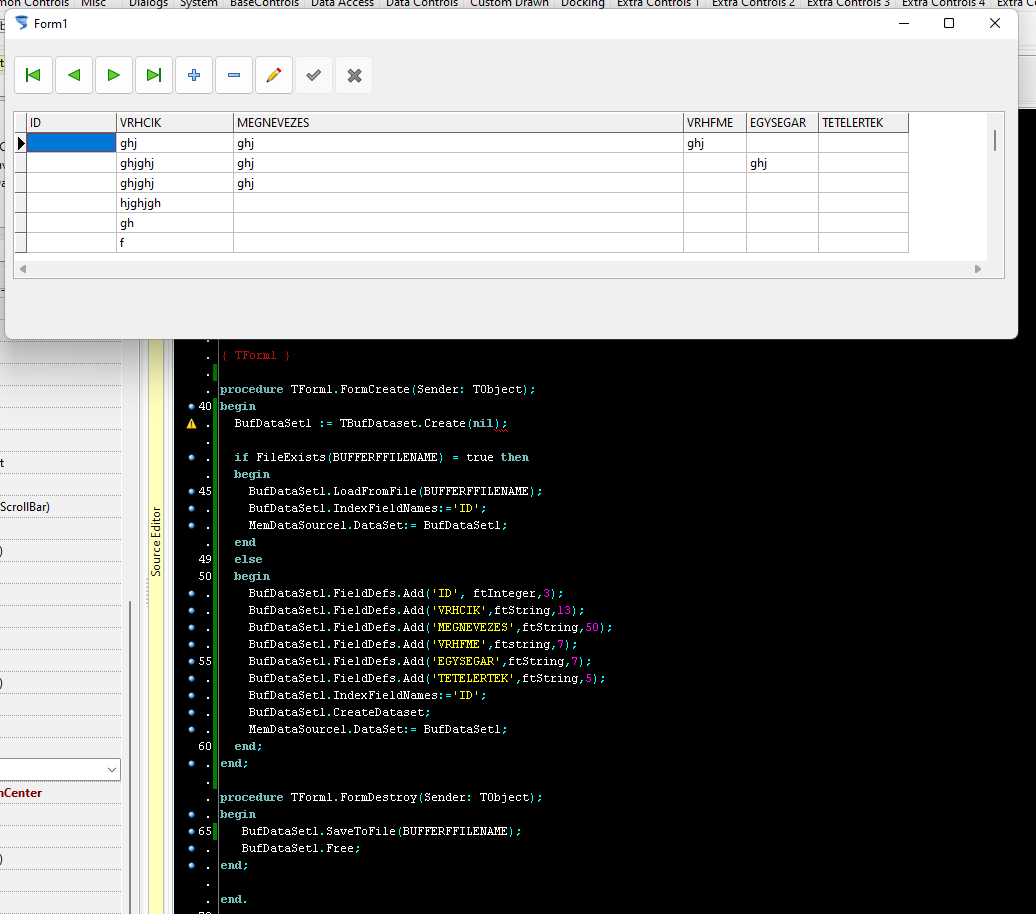

BufDataset error? 4 years 1 month ago #17316
  • prekox maximus
I understand, but how do you read back the saved data from the file? With version 7.5 there was no problem reading back...
BufDataset error? 4 years 1 month ago #17317
Sorry
more tests....
This source work OK from me.
    BufDataSet1.LoadFromFile(BUFFERFFILENAME);
  end
  else
   BufDataSet1.SaveToFile(BUFFERFFILENAME);
   BufDataSet1.Free;
end.
The following user(s) said Thank You: prekox maximus
BufDataset error? 4 years 1 month ago #17318
  • prekox maximus
It is interesting that the SaveToFile method was executed even when the TBufDataSet was released, but after version 7.6 it must be written out in the code...
Thanks for the help, it works!
