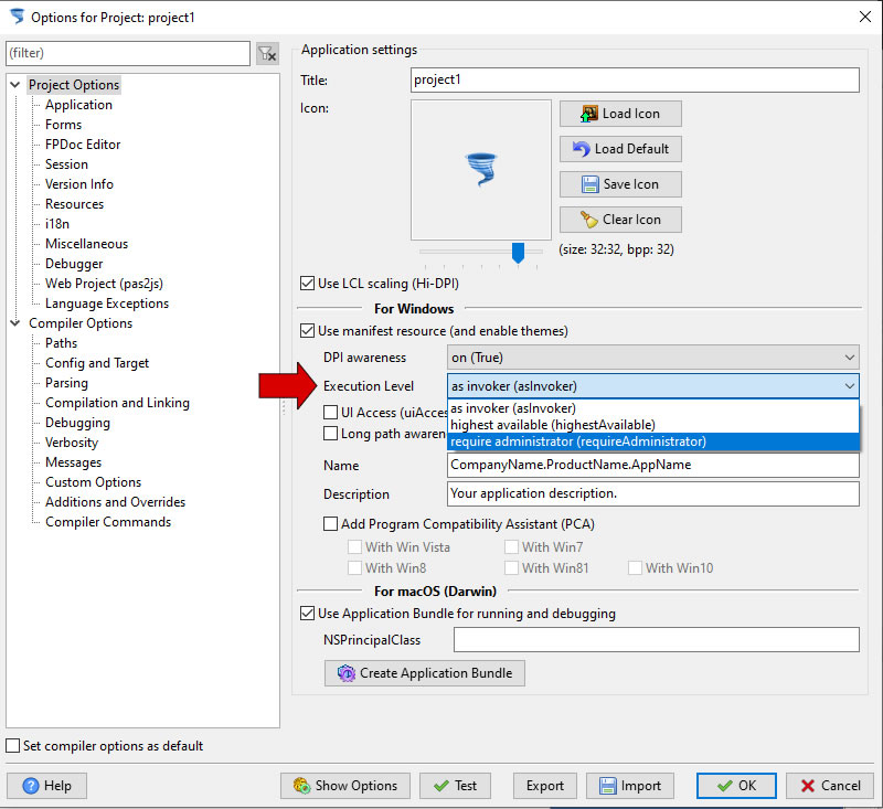

Your target OS ?
Did you try with a Project with "Administrator Execution Level" like CTCenter ?
