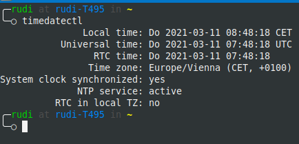

What do you get after entering: timedatectl
GetLocalTimeOffset return 0 5 years 4 months ago #15660
  • Vital
  • Vital's Avatar Topic Author
  • Posts: 88
$ timedatectl
Local time: Пт 2021-03-12 12:16:24 MSK
Universal time: Пт 2021-03-12 09:16:24 UTC
RTC time: Пт 2021-03-12 09:16:24
Time zone: Europe/Moscow (MSK, +0300)
System clock synchronized: yes
NTP service: active
RTC in local TZ: no

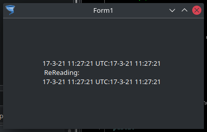

GetLocalTimeOffset return 0 5 years 4 months ago #15673
  • Vital
  • Posts: 88
firliri wrote: Hi, did you test the ReReadLocalTime function ?
var
  s: string;
  s:= DateTimeToStr(Now)+' UTC:'+DateTimeToStr(NowUTC)+#13#10;
  ReReadLocalTime;
  s+= (' ReReading:'+#13#10+DateTimeToStr(Now)+' UTC:'+DateTimeToStr(NowUTC));
  Label1.Caption:= s;
But real time in my timezone 14:27:21
Last edit: by Vital.

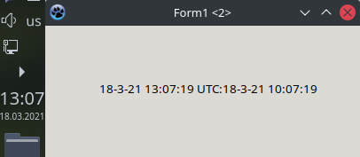

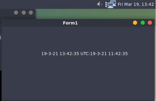

GetLocalTimeOffset return 0 5 years 4 months ago #15691
  • Posts: 4627
  • Thank you received: 1138
after today update from FPC SVN: 49001   more info
With the above source, I get this
On Fedora 33 with the same Local time with your local time (UTC+3)
Just download from SVN the file :
rtl\unix\timezone.inc
and replace the CT file:
codetyphon/fpcsrc/rtl/unix/timezone.inc
Rebuild ALL (FPC and Typhon)
We try hard to offer "On User Side Real Time Support", but sometime we want help ...
The following user(s) said Thank You: firliri
