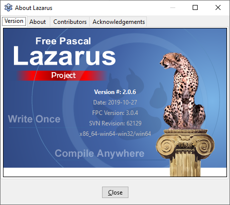

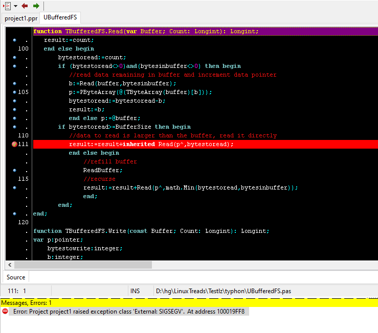

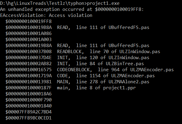

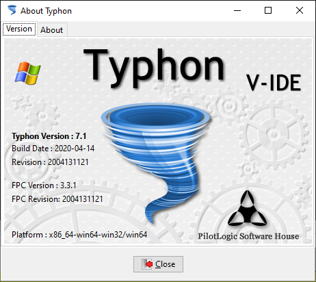

Hello. After updating the old version of CodeTyphon, the following code stopped working (both in the 32bit and 64 bit versions). When trying to debug, it throws: Error: Project project1 raised exception class 'External: SIGSEGV'. There is no problem compiling in Lazarus. I apply the minimum code opening to check the recurrence of the problem.

FPC in your screen is ver 3.0.4
Released "November 28th, 2017" before 3 years.
Please look at codetyphon\CodeOcean\pl_ExCompress\samples\
for the correct use of pl_ExCompress CT pkg
