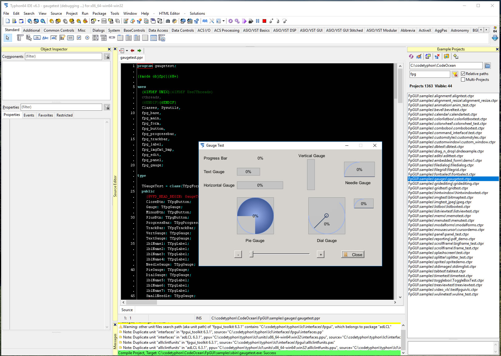

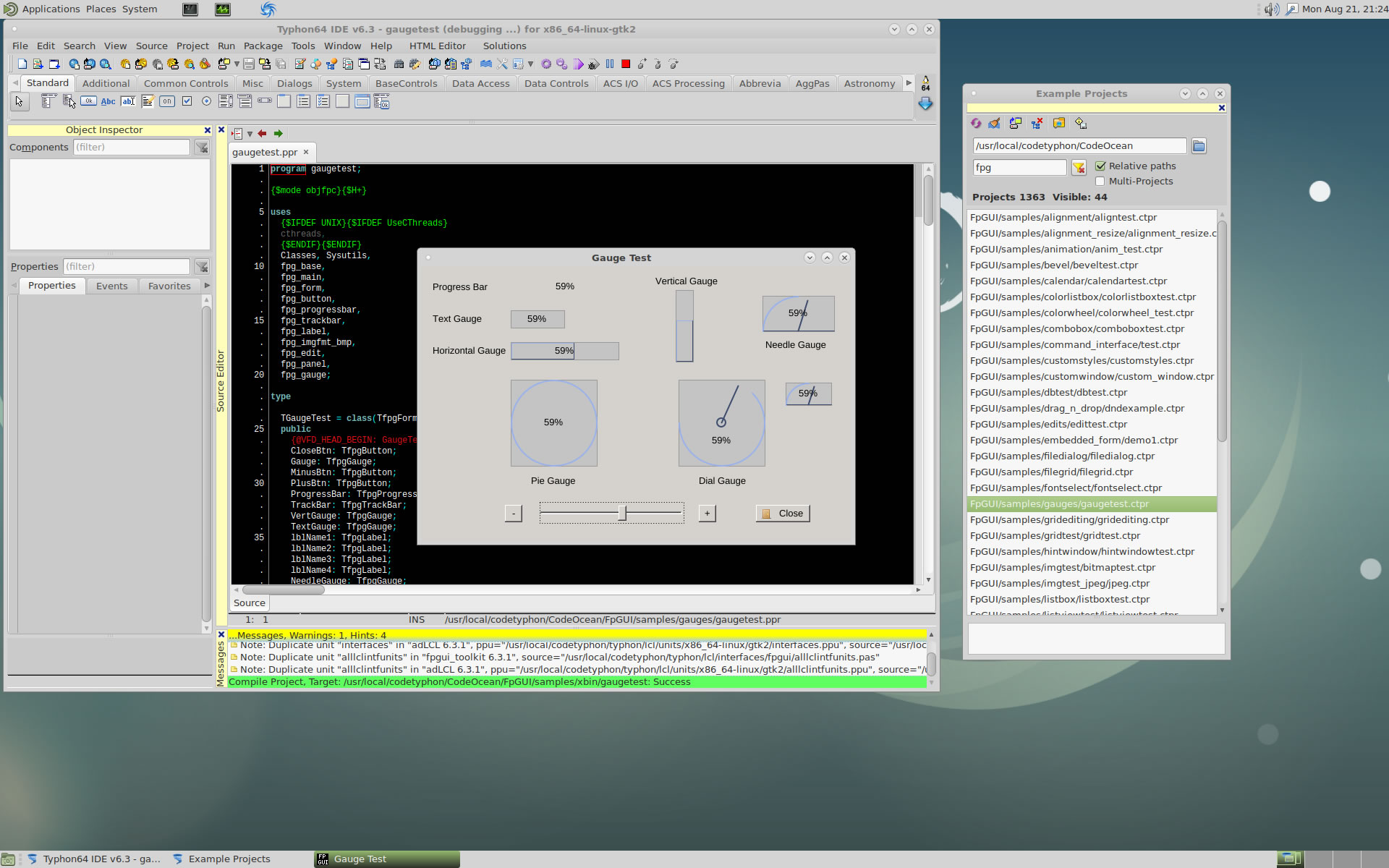

A simple "Thanks" for your work Sir
Screens from:
-Windows 10 64Bits (yes...)
-Debian 9 64Bits
