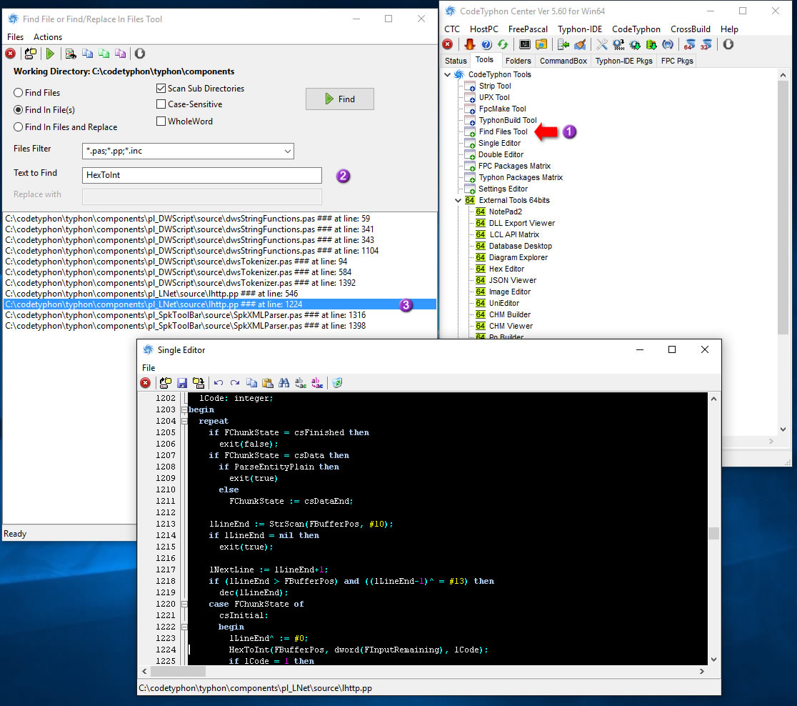

How to convert hex to integer? 11 years 15 hours ago #8597
use "strutils" unit Sir
it's part of FPC rtl-objpas package
function Hex2Dec(const S: string): Longint;
HexToInt don't exists in FPC 3.1.1 trunk
but you can find code samples at :
C:\codetyphon\typhon\components\pl_LNet\source\lhttp.pp line 546
C:\codetyphon\typhon\components\pl_SpkToolBar\source\SpkXMLParser.pas line 1316
C:\codetyphon\typhon\components\pl_DWScript\source\dwsTokenizer.pas line 584
PS: Please use Find files tool of CTCenter to find and text in files
double-click at file line will open CTCenter Editor to view the file
