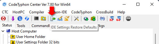

"when deleted the dir '.typhon64'"
Delete the .typhon64 folder it's NOT the correct procedure.
We use CTCenter => "IDE Settings Restore Defaults" .
Will delete .typhon64 folder and will copy "Default Setting" to new .typhon64 folder.
TyphonIDE need "Default Setting" in the .typhon64 folder to work without problems.

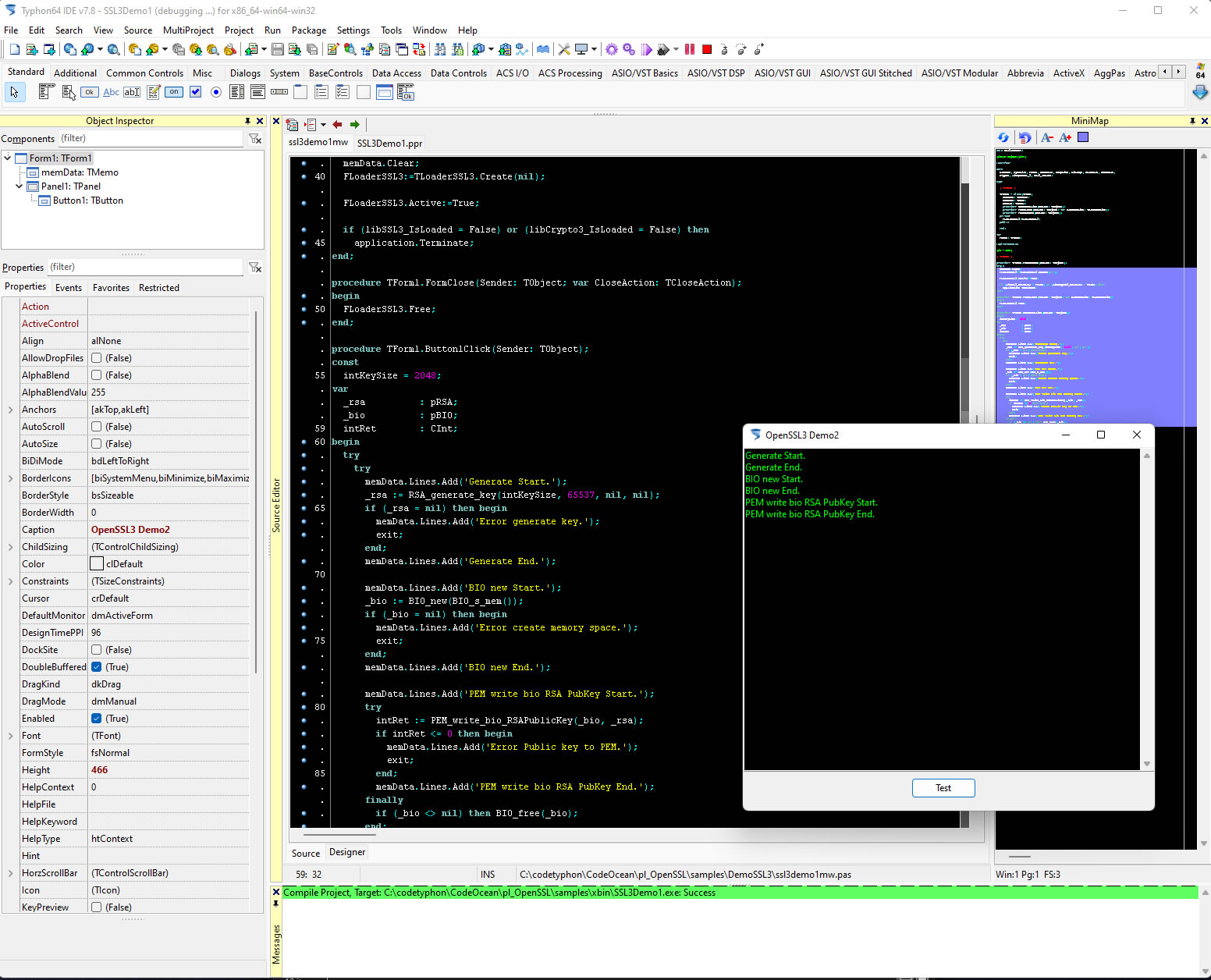

A mysterious phenomenon has occurred with OpenSSL.
It seems that the same phenomenon appears in CT7.80 of Win32 and Win64.
If you code normally, an access violation will occur and
If you insert TMemoryStream and TByte, the process will be completed, but Permission Deneied will be done.
pl_OpenSSL package is under develop status.
Please, only for LAB CT 7.80 revision 007760
In attach file you will find the new LAB pl_OpenSSL (replace old pkg in TyphonIDE)
and your tests projects for SSL3, working correct.
We use "Loaders Tech" in these tests, to load SSL libraries staff from
C:\codetyphon\binRuntimes\x86_64-win64\openssl\
folder.
Win11/Typhon64
Real-Time source support for CodeTyphon Studio.
Have fun......

Hello.
I compiled and installed the attached pl_OpenSSL and used Loader and it worked perfectly!
Thank you very much for your verification and repair.
I will implement it a little more and check the operation.
Best regards.
