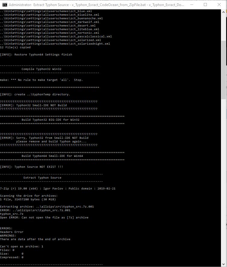

Don't know what's going wrong but after updating and choosing 8. Remove all build all the installation stops with errors when trying to create the two IDE's.
It seems it's missing the Typhon sources but I also see an error message "No rule to make target ALL". (see screenshot attached.
Am I doing something wrong or is there a mistake in the installation script?
CT LAB ver 7.10 6 years 9 months ago #14392
some files on Our Server with problems ...
We Re-create and Re-upload LAB CodeTyphon ver 7.10 Rev 007031
We test new files with CT Update procedure on Windows 10, Fedora 31 and Ubuntu MATE 19.10
ALL OK (MultiArch builds)
Please, try again to Update your CodeTyphon installation to the latest LAB version.

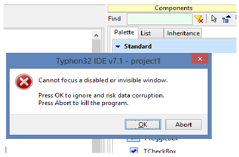

Hello
When I put the cursor in the 'Find' field of the component palette and then press the Enter key, I get the following error message.
(see Pic.: 'Comp_ErrorMessage.png')
Steps to repro:
1. Click into 'Find' Field of 'Components' palette.
2. Press Enter-Key.
Env.: Typhon 7.1 r2002180516 FPC 3.3.1 r2002180516 Platform : i386-win32-win32/win64
Thank you for your support
Daniel
Last edit: by Daniel Jaeger.
CT LAB ver 7.10 6 years 8 months ago #14481
this is a bug, give us time to fix
PS: we fix it,
remove PatternEditKeyDown procedure from codetyphon\typhon\ide\ct_componentlist.pas
and rebuild Typhon IDE
CT LAB ver 7.10 6 years 8 months ago #14482
  • Daniel Jaeger
  • Daniel Jaeger's Avatar
  • Posts: 28
Hello Sternas
if i remove the PatternEditKeyDown procedure i get a 'Access violation' when i try to activate the components list via 'View' or Ctrl+Alt+P. I then tried again by reactivating the procedure but marking the following two lines of code as comments.
// CTSetFocusToDataList(PageControlF, TreePalletteF, ListboxComponentsF, TreeInheritanceF);
// CTSetFocusToDataList(PageControlM, TreePalletteM, ListboxComponentsM, TreeInheritanceM);
It works now.
Regards
Daniel
