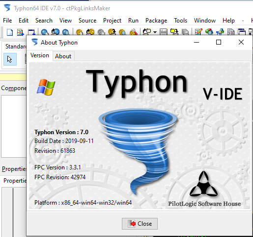

> LAZARUS FPC Rev 42374 - no problem
Sorry, I do not understand, Lazarus do not use yet fpc 3.3.1, only CodeTyphon use it.
Officially, Lazarus can use only fpc 3.0.4.
Fre;D

> It's the same in CT...
Ha, ok, perfect.

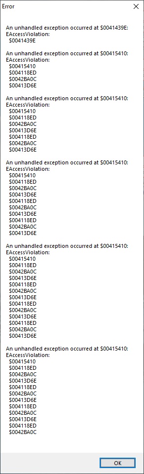

  • Nicola
  • Nicola's Avatar
  • Posts: 30
Hello, everyone,
In Typhon 32 if I dock the object inspector or the message window or any other window to the source editor, when closing CodeTyphon, I get the error in the figure. Vice versa if the windows are not docked I don't find any problem.
Everything is OK with Typhon 64.
I use version 6.90 on windows 10 64 with 16 GB of ram.
No problem with version 6.80
CT LAB ver 6.90 7 years 1 month ago #13751
  • Posts: 1436
  • Thank you received: 233
we will test and report
