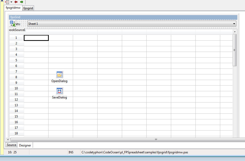

Sorry, but I have just installed the released 6.5 and now the worksheets (TsWorksheetGrid, Spreadsheet page), appear with the column headers empty; please see attached capture, from sample project fpsgrid in pl_FPSpreadsheet.
