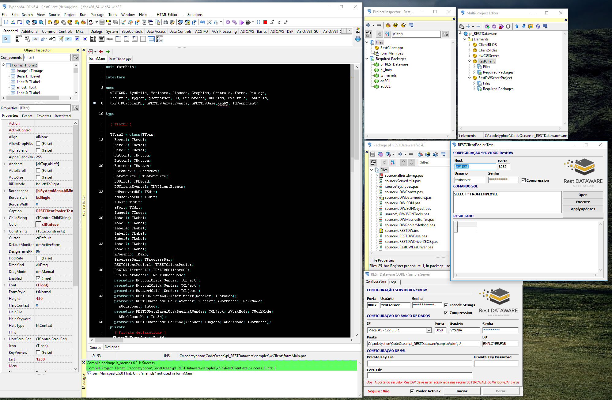

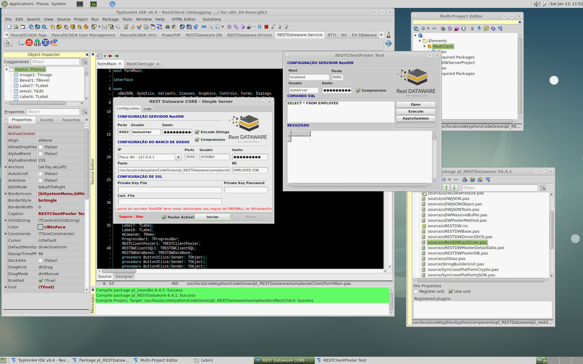

CT LAB ver 6.40 8 years 3 months ago #11306
  • Posts: 4620
  • Thank you received: 1132
We port your library to CodeTyphon Studio
with some changes for Unix...
This is NOT the final version,
we don't test the full functionality yet.
We must test and FreeBSD, Solaris, MacOS, arm-linux (Pi3) etc...
Attach1: pl_RESTDataware package
Attach2: some CodeOcean samples for pl_RESTDataware package
Attach3: Win10-64 tests....
Attach4: Debian 9 32/64bits Linux tests
have fun....
