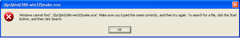

Windows XP 32
update version 5
Remove and Build ALL
problems: make.exe
Last edit: by zeljko.
CT LAB ver 5.00 12 years 3 months ago #5707
we fix and this at revision 004935

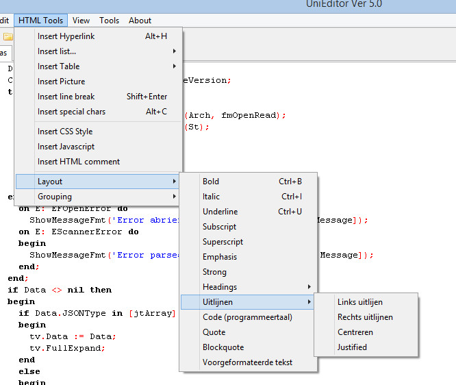

some words in UniEdit (dutch, deutsch ... no idea :) )
Font Type instead of Lettertype ... sound better for me
...nothing serious

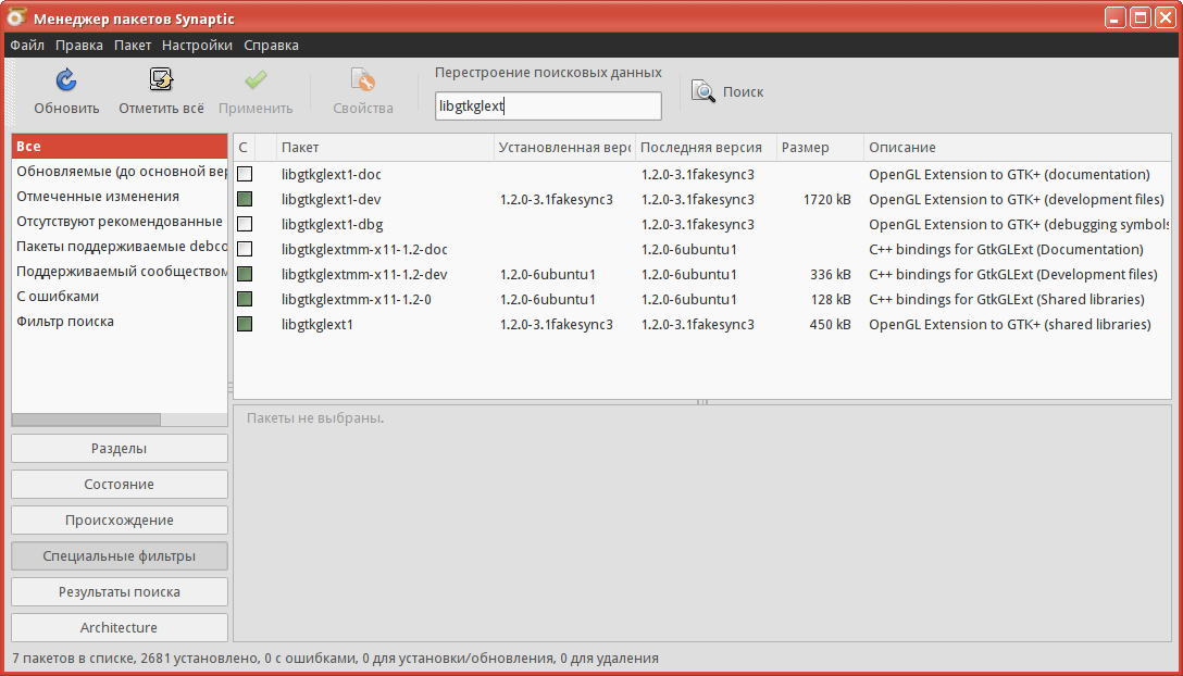

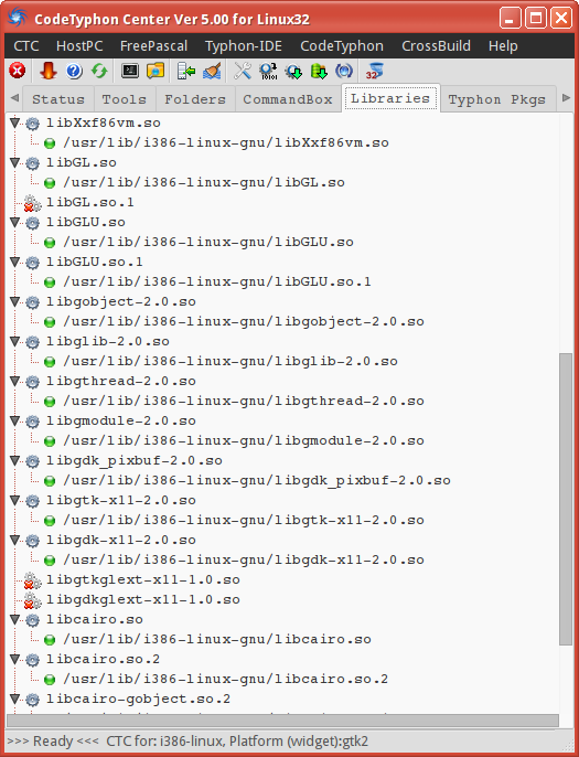

Oh, also libraries status tab is trying to find some libs in all-wrong places or of an all-wrong version.
While I can understand the absence of some QT libs, I just can't get why some other libs are missing after the "Install system libraries" option has been selected:
Currently my libgtkglext is of version 1.2, not 1.0:
So, why not search for some basic name and make symlinks if CT needs other versions and there's NO required version of any particular lib but there IS a higher version?
Or maybe it's worth trying to add some repos to OS to ensure there's the needed version of any lib CT, well, needs?
Anyway, please, pay attention to the "Invalid utf-8 string" error too.
