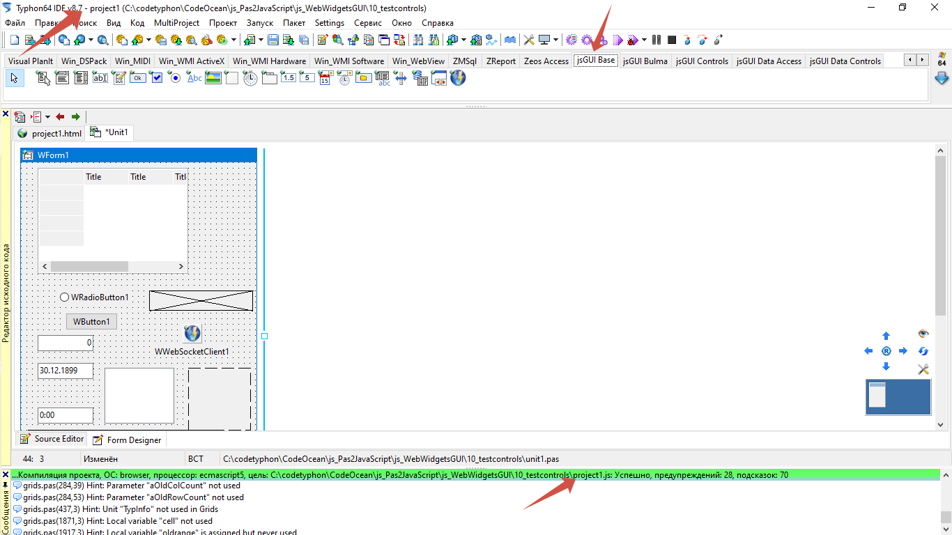

I have found examples in CodeOcean for js_WebWidgetsGUI.
Folder - CodeOcean\js_Pas2JavaScript\js_WebWidgetsGUI.

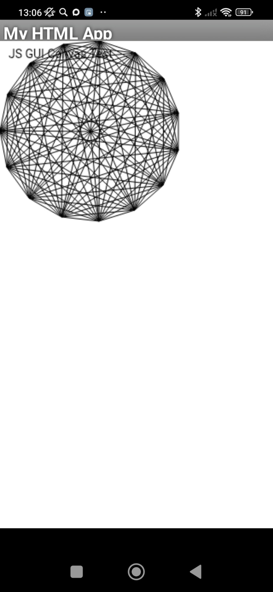

I have build in CT 8.7 this project CodeOcean\js_Pas2JavaScript\js_WebWidgetsGUI\20_tests.

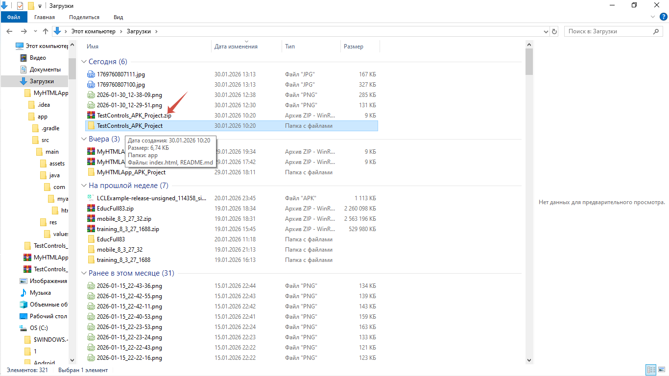

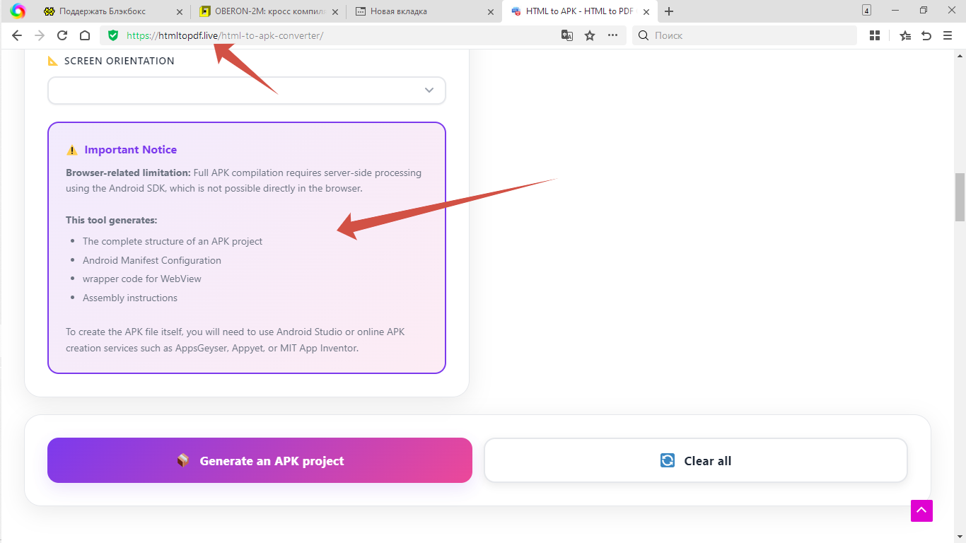

I used testCanvas.html from the folder "20_tests" and this site htmltopdf.live/html-to-apk-converter/
to create project of Android App.
After that I have added the folder "assets" to the project.
And copied the files "testcanvas.js" and "testcanvas.js.map" into it.

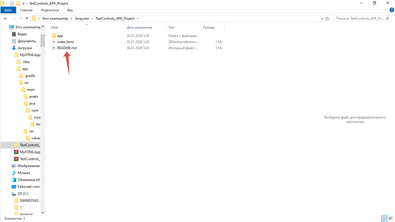

Then I have build the project with sdk in Android studio.
The instructions are given in file Readme.md
Check this file in downloaded zip-archive from the site htmltopdf.live/html-to-apk-converter/ .

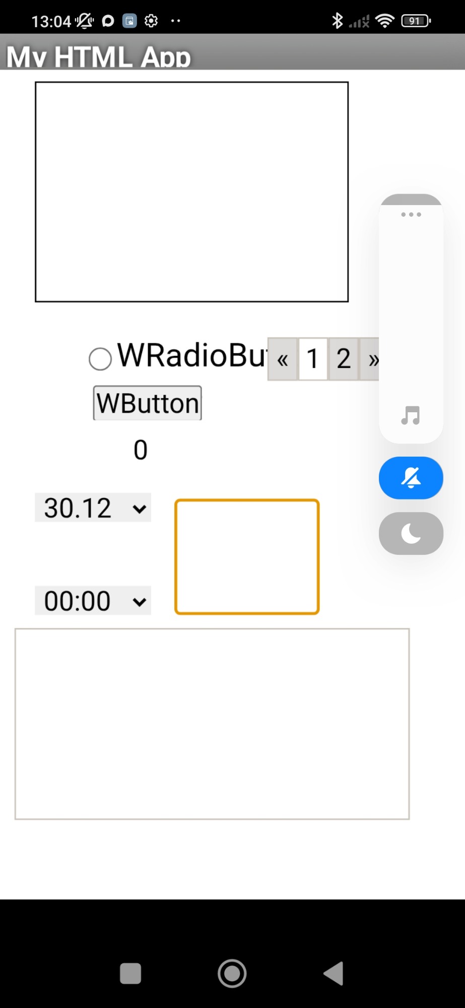

After that I have build another the project - CodeOcean\js_Pas2JavaScript\js_WebWidgetsGUI\10_testcontrols
And did the same steps I have mentioned above to create and build Android app.
Both Android applications successfully started on smartphone with Android 12.
More information - on screenshots attached.
On tab jsGUI Base in CT there are many ready to use components .
