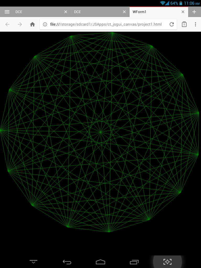

Screenshot of the example running on Tablet web browser.
