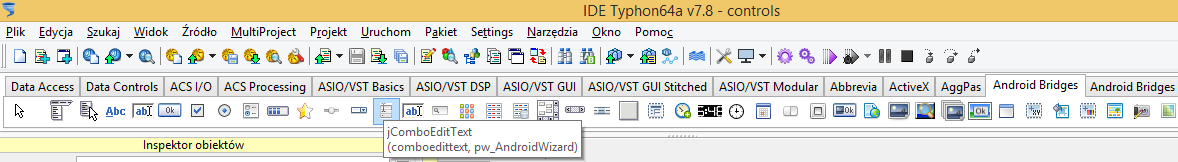

ComboEditText / Memo / Spinner 4 years 2 months ago #17195
CodeTyphon don't have any ComboEditText component
Please, can you give us more info ?

I use Codetyphon64 and there on the tab "Android Bridges" are jComboEditText. Please see attachment.
