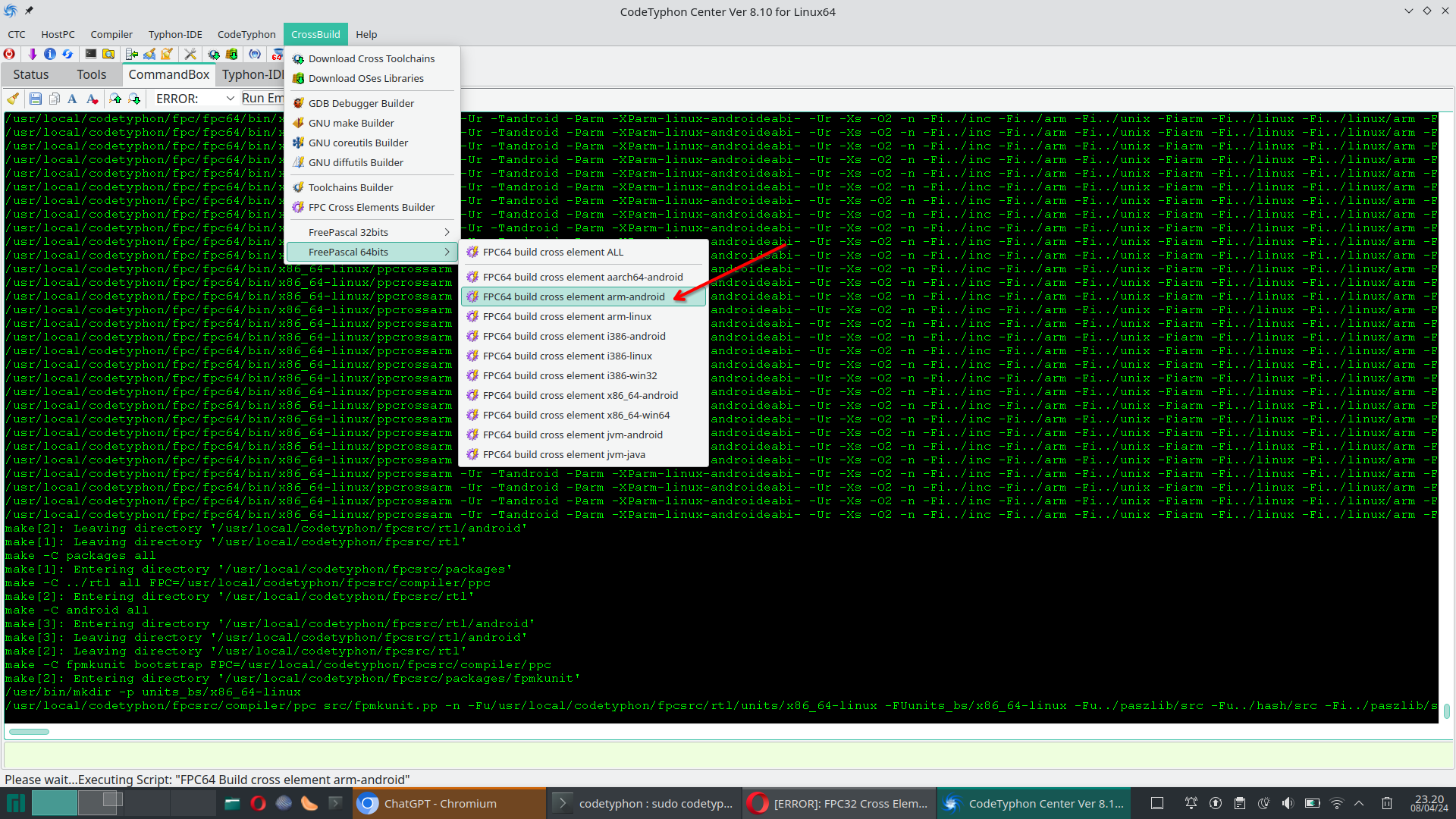

Please try,
Freeepascal 64 bit -> Build cross element arm-android
[ERROR]: FPC32 Cross Element arm-android Param:xxxx NOT Exists 2 years 3 months ago #18405
  • choki
  • choki's Avatar Topic Author
  • Posts: 70
Stage 5: Copy Files and Units
[INFO]: Move FPC Cross compiler units...
[FINAL INFO]:-- !!! FPC64 arm-android Param:xxxx Cross Build Element Build OK !!! --
Terminate Action at 8-4-24 18:33:14
Total time: 00:07:44.498
ExitCode : 0
Last edit: by choki.

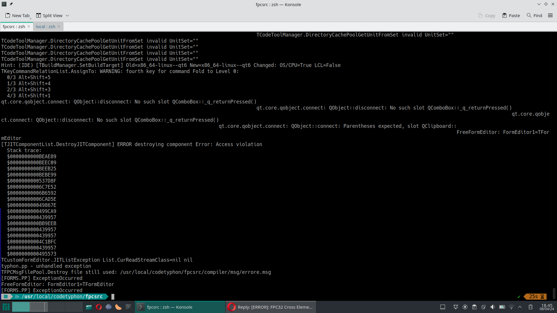

[ERROR]: FPC32 Cross Element arm-android Param:xxxx NOT Exists 2 years 3 months ago #18406
  • choki
  • Posts: 70
Another error, when try to configure project option
adding path, hit ok
then CT crash
[ERROR]: FPC32 Cross Element arm-android Param:xxxx NOT Exists 2 years 3 months ago #18407
  • Posts: 1412
  • Thank you received: 224
on QT6 ?
[ERROR]: FPC32 Cross Element arm-android Param:xxxx NOT Exists 2 years 3 months ago #18408
  • choki
  • Posts: 70
yes

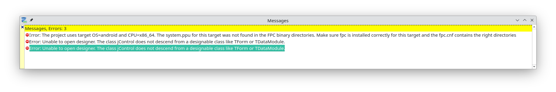

[ERROR]: FPC32 Cross Element arm-android Param:xxxx NOT Exists 2 years 3 months ago #18410
  • choki
  • Posts: 70
When open CodeOcean sample for android,
Error: The project uses target OS=android and CPU=x86_64.
The system.ppu for this target was not found in the FPC binary directories.
Make sure fpc is installed correctly for this target and the fpc.cnf contains the right directories.

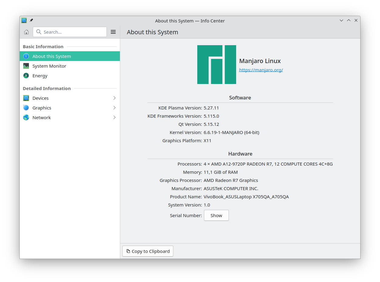

inxi output:
CPU: quad core AMD A12-9720P RADEON R7 12 COMPUTE CORES 4C+8G (-MT MCP-)
speed/min/max: 1602/1400/2700 MHz Kernel: 6.6.19-1-MANJARO x86_64 Up: 5d 1h 0m
Mem: 4.57/11.14 GiB (41.0%) Storage: 931.51 GiB (26.1% used) Procs: 352
Shell: Zsh inxi: 3.3.33
[ERROR]: FPC32 Cross Element arm-android Param:xxxx NOT Exists 2 years 3 months ago #18411
  • Posts: 1412
Fresh install QT6
QT6 need more tests Sir
[ERROR]: FPC32 Cross Element arm-android Param:xxxx NOT Exists 2 years 3 months ago #18412
  • Posts: 1412
inxi output:
Did you build OS=android and CPU=x86_64. FreePascal CrossElement ?
with CTCenter ?
[ERROR]: FPC32 Cross Element arm-android Param:xxxx NOT Exists 2 years 3 months ago #18413
  • choki
  • Posts: 70
Did you mean, this?
crossbuild->Freepascal 64 bit-> elemen arm android?
yes already do that
