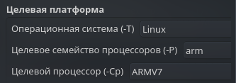

My project params:
***Setup and target platform***
- OS: Linux
- CPU family: arm
- CPU target: ARMV7 or NULL

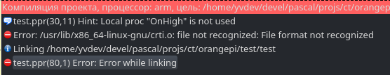

Errors:
Error: /usr/lib/x86_64-linux-gnu/crti.o: file not recognized: File format not recognized
test.ppr(80,1) Error: Error while linking
What am I doing wrong?

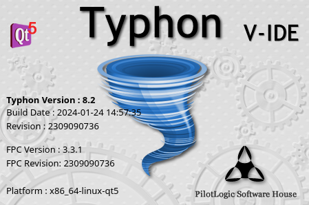

Your CT version ?
On Debian 12 CrossCompile To arm-linux-pi 2 years 7 months ago #18362
  • Vital
  • Vital's Avatar Topic Author
  • Posts: 88

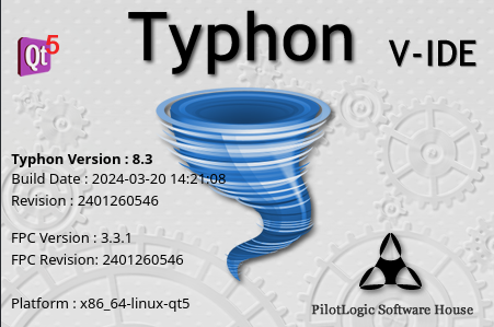

Please try and CT ver 8.30
On Debian 12 CrossCompile To arm-linux-pi 2 years 7 months ago #18369
  • Vital
  • Posts: 88
Nothing changed. Same error:
Last edit: by Vital.

My project params:
- OS: Linux
- CPU family: arm

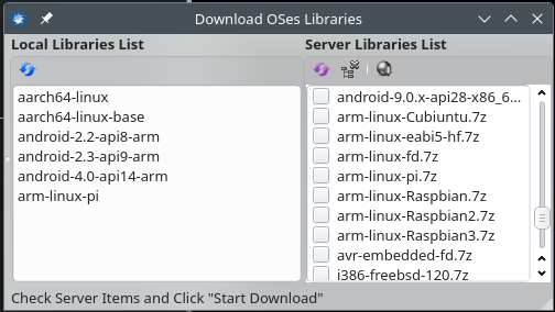

Indicate in the list "Server Libraries List" in the screenshot which one you need, if mine is not correct...

Test and OS Libraries:
-arm-linux-fd
-arm-linux-Raspbian3
On Debian 12 CrossCompile To arm-linux-pi 2 years 7 months ago #18377
  • Vital
  • Posts: 88
-arm-linux-fd
Works. Thank you!
