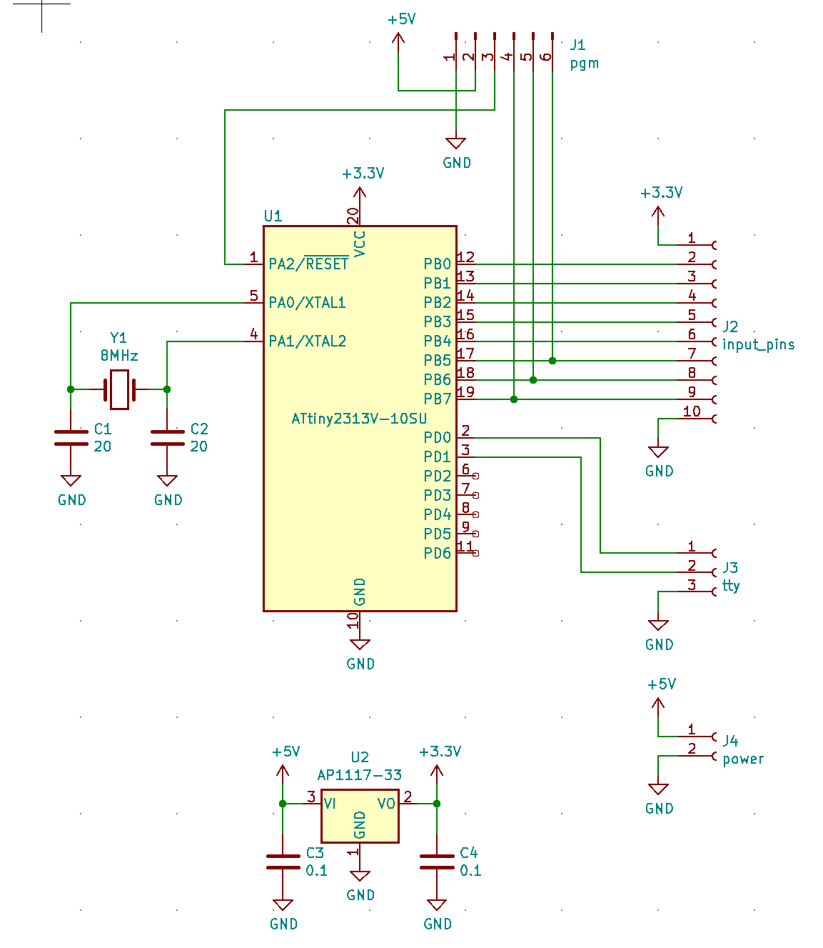

In my project, the connected equipment can change the state of a pin several times in one millisecond. If I run a thread without sleep(1), then the processor is 100% busy and it overheats and freezes. If I put it to sleep(1), then I may not notice the change in the state of the pin.
GPIO (Orange PI + wiringOP) 2 years 8 months ago #18269
  • Vlad Wilhelm
  • Vlad Wilhelm's Avatar
  • Posts: 35
In this case my solution is not suitable. I use signal lines for slow processes. However, I'm not sure that state changes with a frequency of tens of hertz are suitable for the built-in GPIO. It might make sense to consider some external hardware implementation with data pumping through a serial port or via TWI.
For example like this:
