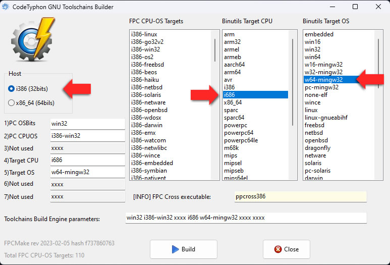

To build Toolchains for i386-win32 you must set:
Anything you build with new Cross engine MSYS2, Toolchains, GNU make, GNU GDB etc
for i386-win32 the
Tatget CPU is: i686
Target OS is  : w64-mingw32

OK. I'll try it with w64-mingw32 as you suggest but my Host is x86_64 not i386 ...
