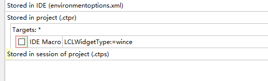

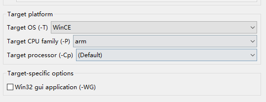

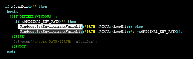

now ,we update Ct to V7.8 from CT7.6, i create empty WinCE app, but  compile error!
after force to pwidechar(),but below error, Windows.SetEnvironmentVariable unknown method!
in CT 7.6 is ok,
 project options see attachments.

a) Replace
C:\codetyphon\typhon\components\BaseEngines\System\sysloader.pas
C:\codetyphon\typhon\components\BaseEngines\Graphica\gaengine.pas
C:\codetyphon\typhon\components\BaseEnginesPlus\source\Graphica\gabitmapplus.pas
with fixed files from attach CT78WinCEFix.7z file
b) ReCompile
bs_Engines and bs_EnginesPlus packages.

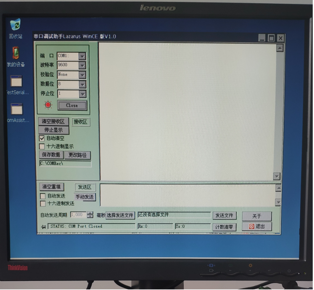

Thank you for your quick reply,I have updated it and tested it on the real machine. Everything is normal!
See the attached screenshot!
