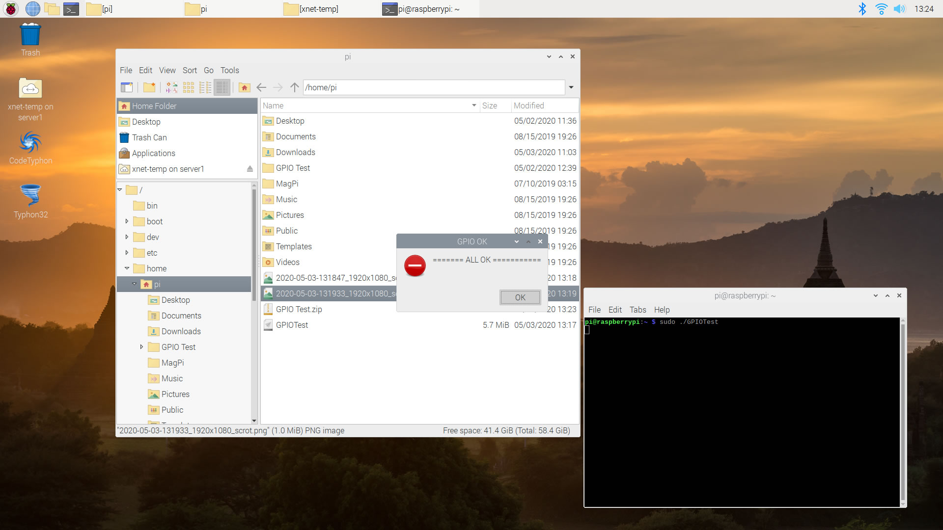

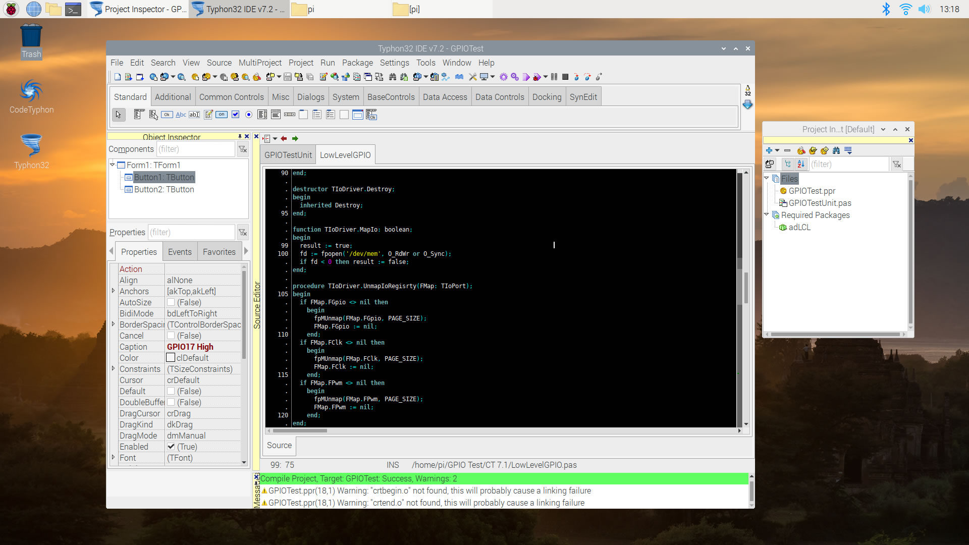

CT 7.1 kills my code 6 years 6 months ago #14664
After tests and fix your code, all works OK
Test on Raspberry Pi 3 Model B+ with latest Raspbian
and LAB CodeTyphon installed for debugging.
You can download your project with my fix from here
I execute your fixed projects with command
sudo ./GPIOTest
because normal Raspbian user (pi) do NOT have permition to open /dev/mem for Read and Write
line 100 at your unit LowLevelGPIO.pas
and some live screens from my tests
LAB CT on Raspberry Pi 3 Model B+ with latest Raspbian
sudo ./GPIOTest
