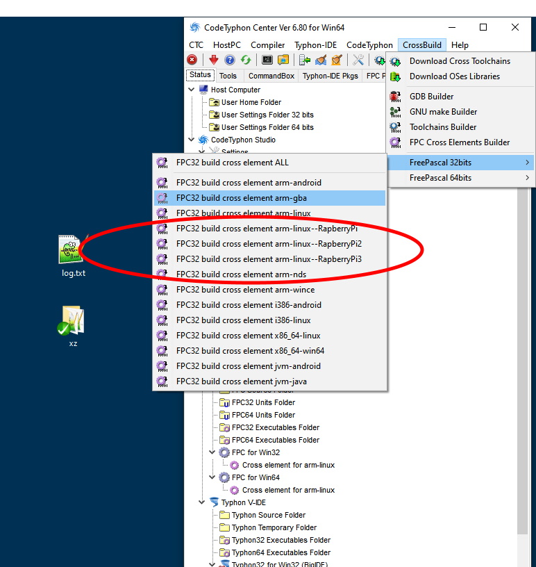

on Codetyphon I can download Toolchains for Raspberry pi, Raspberrypi2 and Raspberry pi 3 for 32 and 64 bit;
What Is the differences???
On library on Codetyphon if i set for a device Raspberry pi3 a path of library of raspberry, what problems can I have?
Thanks in advance.

I didn't explain myself well;
I builded in Codetyphon 6.80 in Windows 64 for Raspberry pi3b an executable inserting in the path library first "arm-linux-Raspbian", then "arm-linux-Raspbian2" and for final "arm-linux-Raspbian3";
so with winmerge I checked the executable differences between the 3 files and the executable compiled with the Raspbian2 and Raspian3 library are the same while the one with Raspbian1 changed little, but was not the same.
The first file compiled with arm-linux-Raspbian is the size of a few smaller bytes while the other two are equal.
Alle three executable works well on Raspberry3.
I would like to understand the difference between the three libraries, since they generate very very similar code (between 2 and 3 is equal among other).
Thanks in advance.
