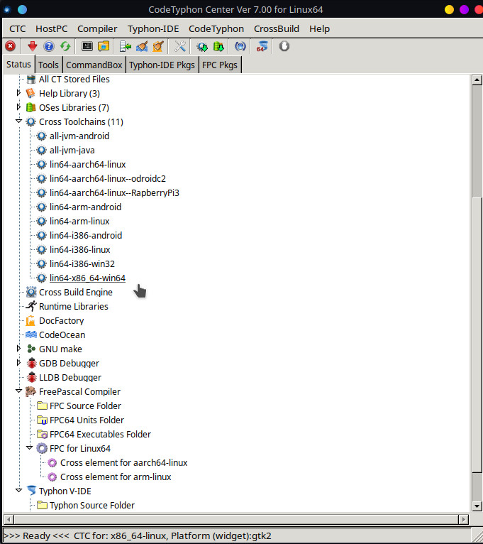

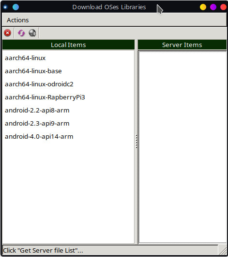

My OS Kubuntu 20.04 x86_64. And status in CTC:
Options for project:
Dowmloaded libraries:

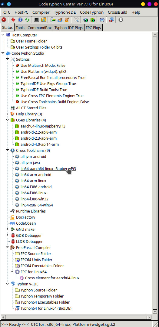

Raspberry pi3b+ 6 years 6 months ago #14721
please update CT to 7.10
Raspberry pi3b+ 6 years 6 months ago #14735
  • Vital
  • Vital's Avatar
  • Posts: 88
Sternas Stefanos wrote: Sir
I'am updated.

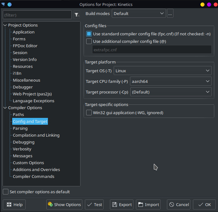

Raspberry pi3b+ 6 years 6 months ago #14736
Did you add in your project to path "Libraries" the "aarch64-linux" target libraries ?
if NOT
Go to your project paths
and add to "Libraries"
the path of "aarch64-linux" target libraries
/usr/local/codetyphon/bin/binLibraries/aarch64-linux-RapberryPi3/
like this
Raspberry pi3b+ 6 years 6 months ago #14737
  • Vital
  • Vital's Avatar
  • Posts: 88
Sternas Stefanos wrote: Did you add in your project to path "Libraries" the "aarch64-linux" target libraries ?
if NOT
like this
Thank you so much!
