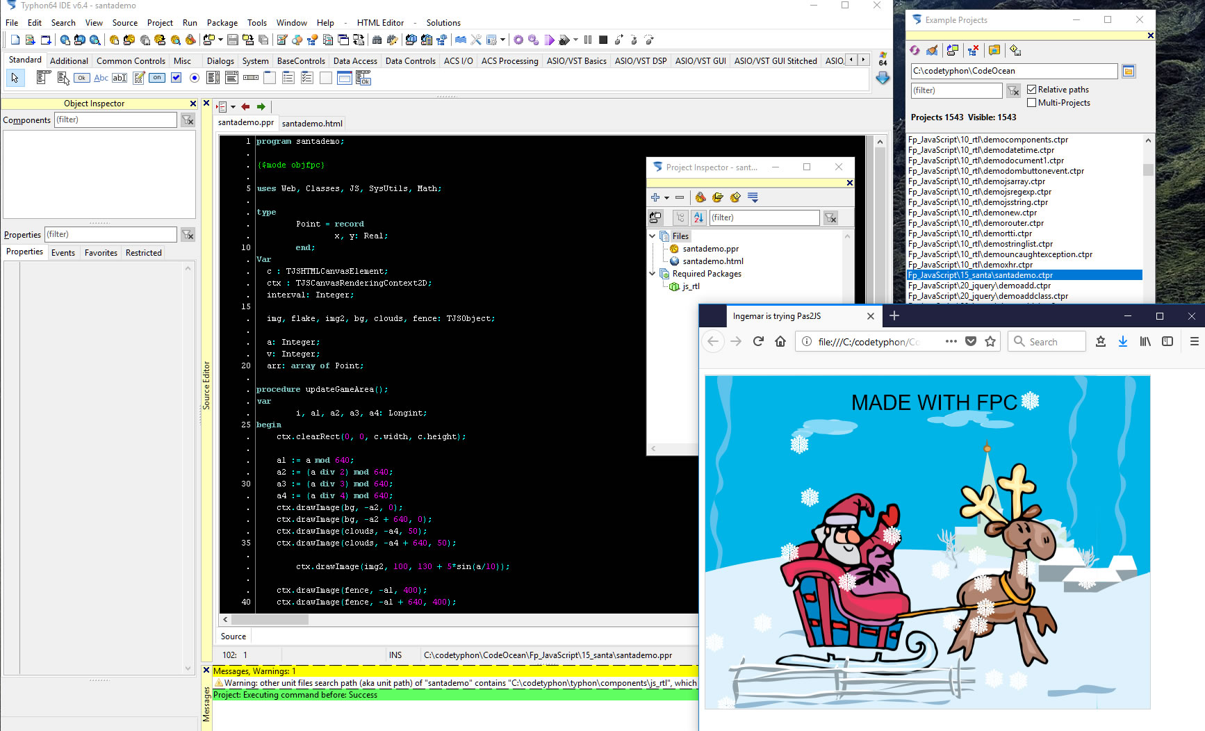

and now comes the "Dual personality" of Android
-For Low level System Libraries you can use Pascal or C/C++ ( targeting to Android NDK API)
-For Android GUI Application (native java)
--- you must use Java or FPC pas2jni info
OR
--- to make your own GUI API like CT customdrawn platform
But FreePascal Team is working on pas2js pascal to JavaScript
and I think the improve of pas2jni is the next FPC target
LAB CT 6.4 on Win64 now..
