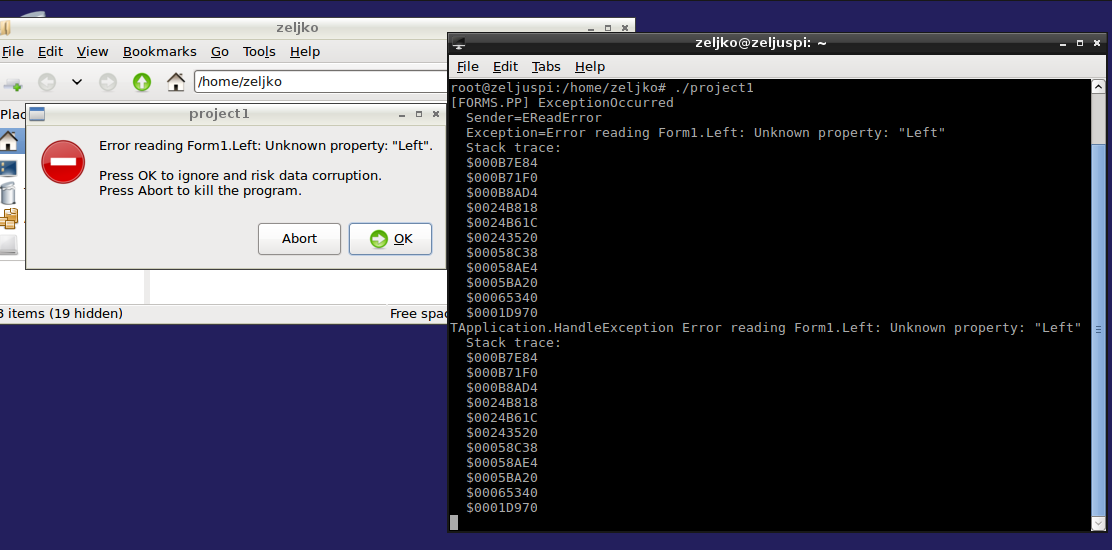

But when start program I get
HandleExeption error reading fmtest.Left: Unknown propert y: "Left"

problems start application to Raspberry PI 2, Raspberry PI 3 and Orange Pi zero
not wokr to board!

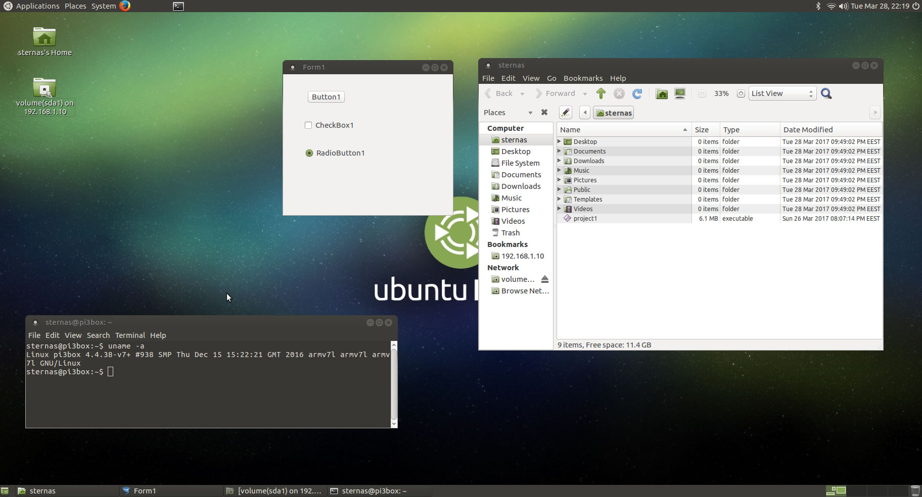

Cross Compiling on Rasppery pi 2 not work 9 years 5 months ago #10658
Well now we have 3xPi3
So, we test Ubuntu-16-04 with MATE desktop
(ubuntu-mate-16.04.2-desktop-armhf-raspberry-pi.img.xz)
the CodeTyphon test project from my previews post
All are OK

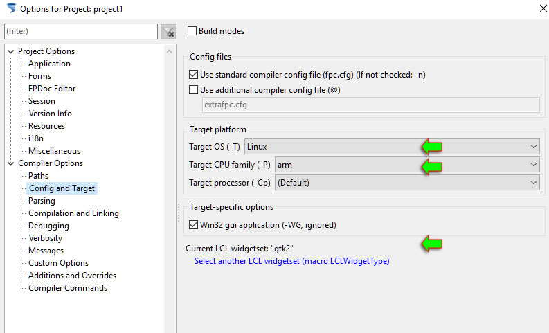

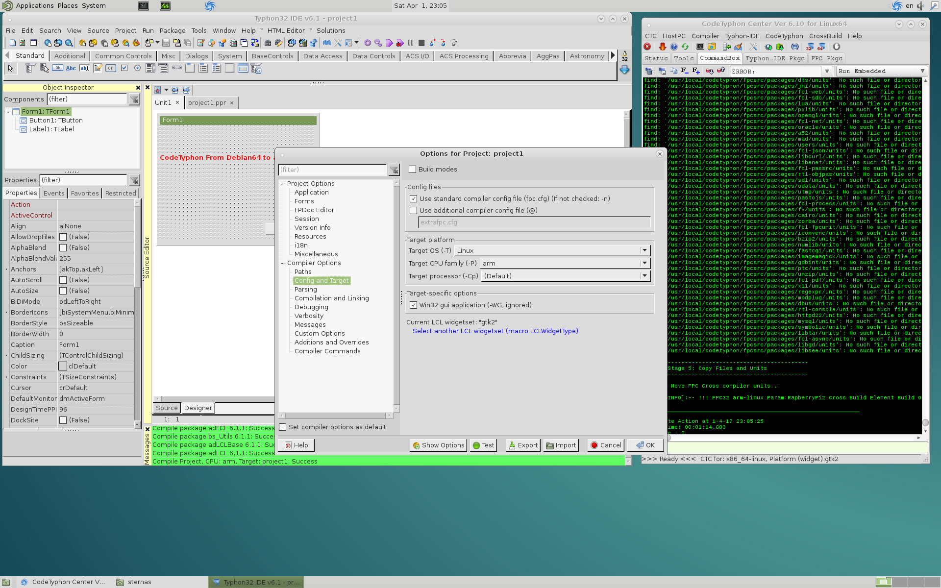

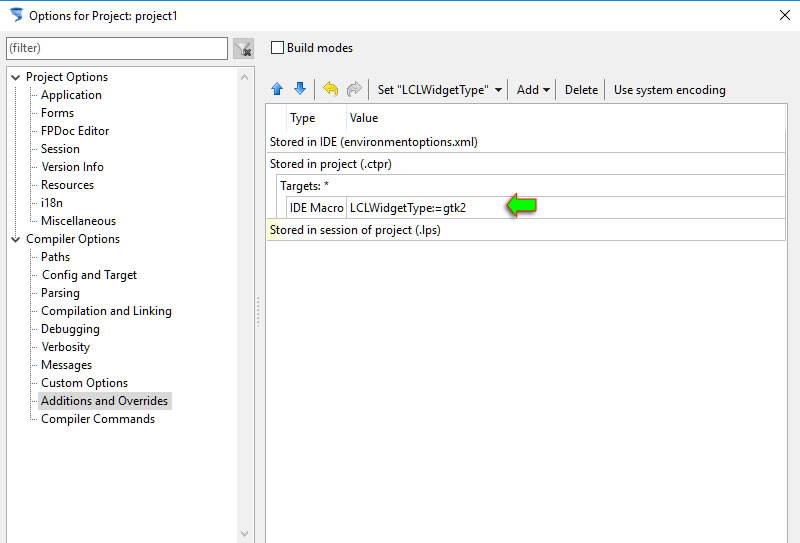

we found the problem

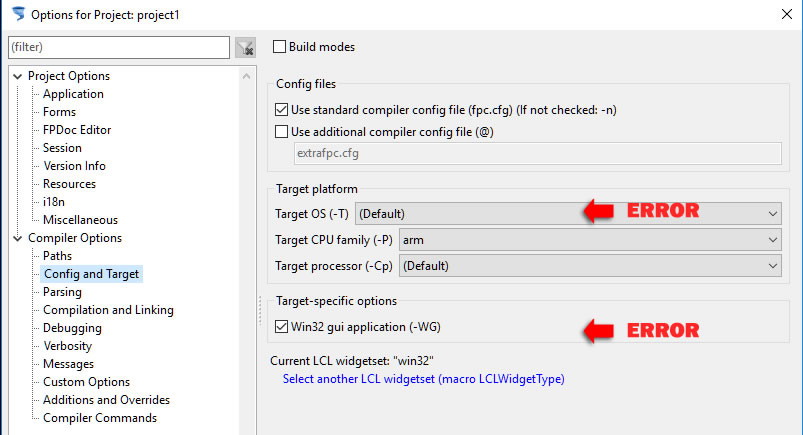

This NOT correct for Pi2-3
You must set platform=GTK2
Finally the correct setup for Pi2-3 is
On the right the No correct project
On the left after above corrections
PS: We start CT tests on Pi3 as hostOS...

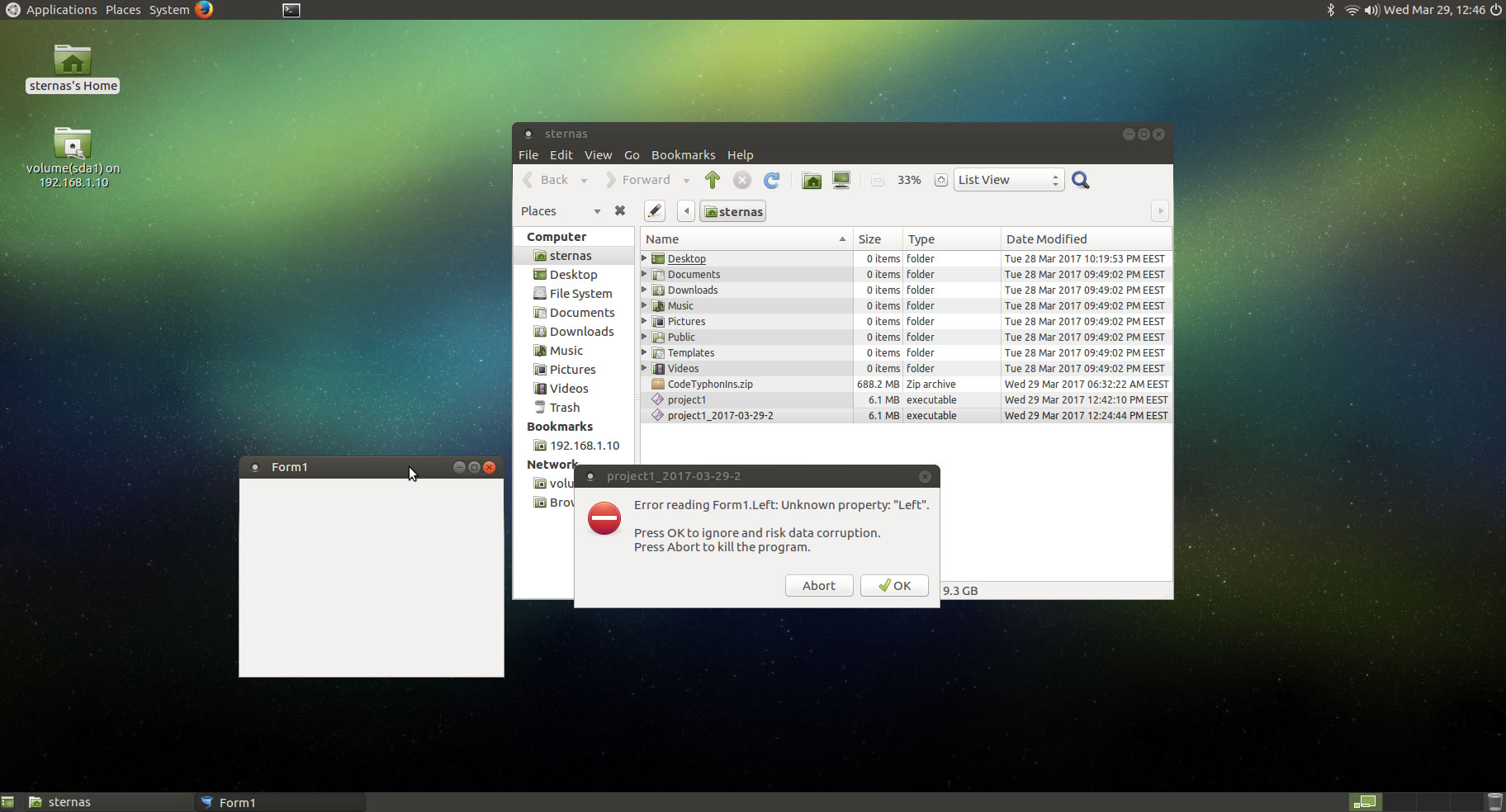

Linux debian 3.16.0-4-amd64 #1 SMP Debian 3.16.39-1+deb8u1 (2017-02-22) x86_64 GNU/Linux
LAB CodeTyphon 6.10 Revision 006030 BETA1
I did as instructed but it is the same error as before.
Please attach your compile program.
I want to help find where the problem is.
(in the equipment or CT)

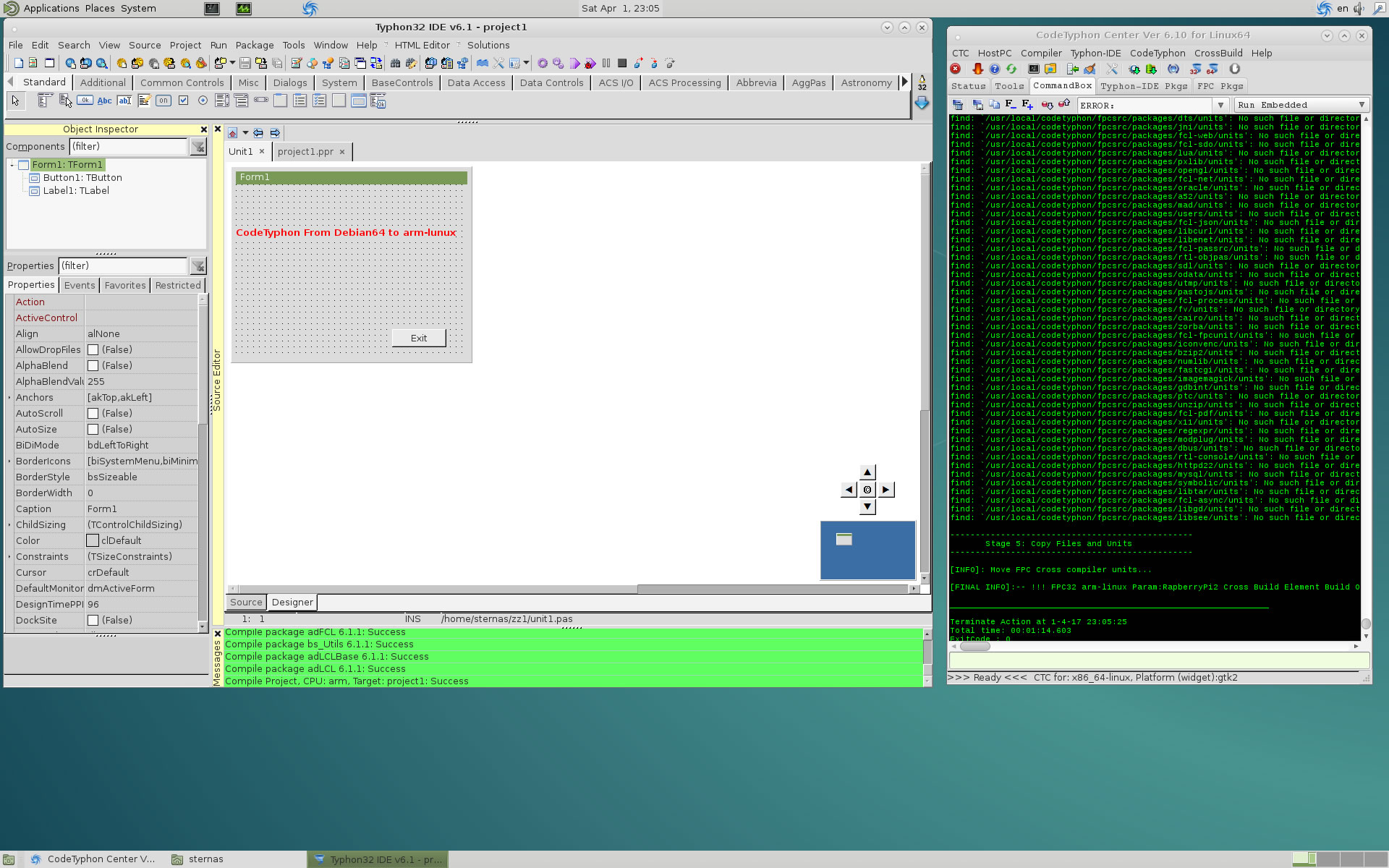

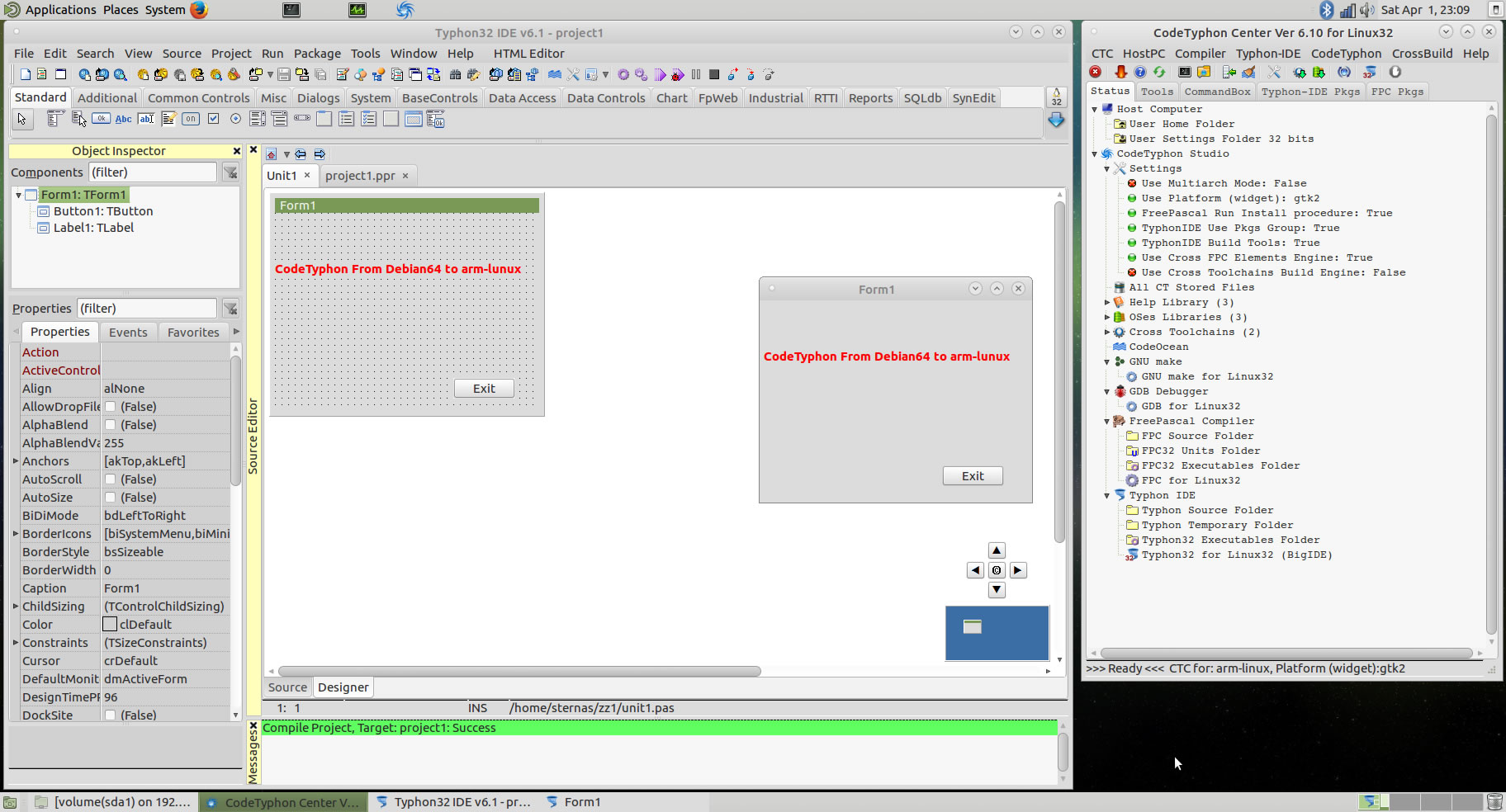

We test on latest Debian 64
Cross build Typhon64 => arm-linux-Pi2 has the same problem
we make a lot of test with NO success :S

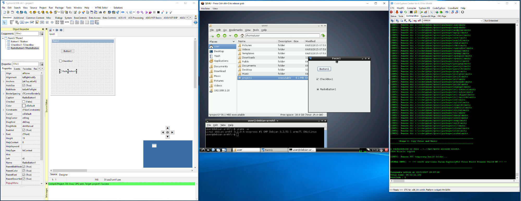

But, On Debian64 CT MultiArch
Typhon32 => arm-linux-Pi2 Works OK !!!

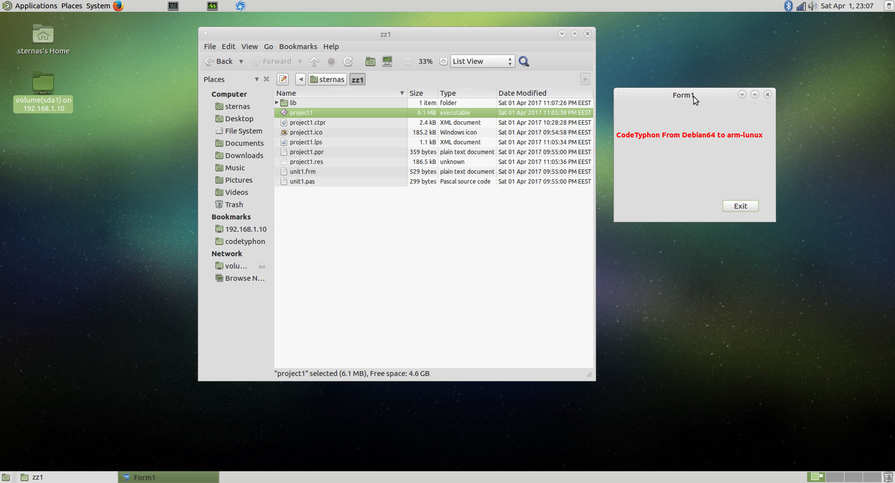

Download Test Project here
Test of above project on Real Pi3 B with arm Ubuntu 16.04 MATE
Now, Lab CodeTyphon 6.10 revision 006040 (No Released yet)
Support arm Pi3 as HostOS... :silly:
