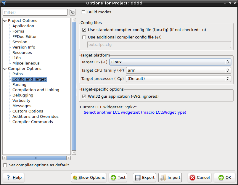

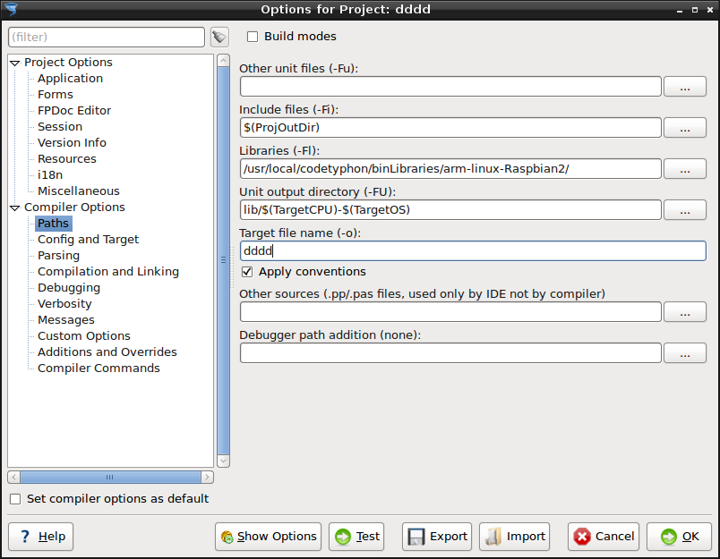

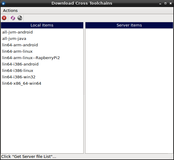

CT5.9 FPC64 arm-linux :RapberryPi2 not build program 9 years 11 months ago #10314
  • usbdoo
  • usbdoo's Avatar Topic Author
Debian 64
CT 5.9
/bin/rm -f base.build-stamp.*
Stage 5: Copy Files and Units
[INFO]: Move FPC Cross compiler units...
[FINAL INFO]:-- !!! FPC64 arm-linux Param:RapberryPi2 Cross Build Element Build OK !!! --
Terminate Action at 26-11-16 14:20:55
Total time: 00:00:46.573
ExitCode : 0
registerfcl.pas(45,22) Fatal: Cannot find process used by RegisterFCL of package FCL.

We found the problem
please,
test the new cross-build scripts and report

Congratulations for the good work.
Now it works.
Thanks.
