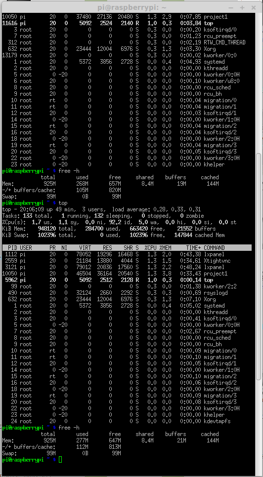

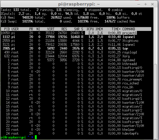

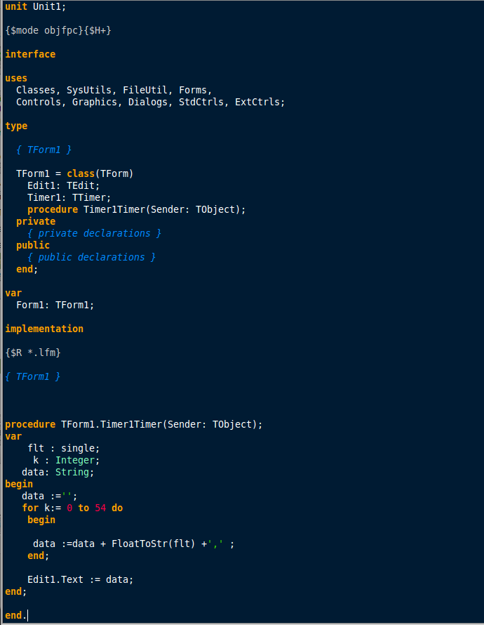

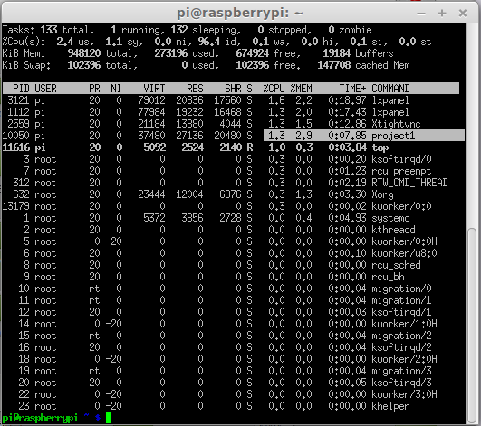

I am making a program in my PIBox 2 It must run 24/7 is it for data acquisition. I noticed when I use String variable or Arrays that the memory gets smaller.
Is this normal , is possible make a clear to free memory.
I send a little program
and the result with the memory leaks.
