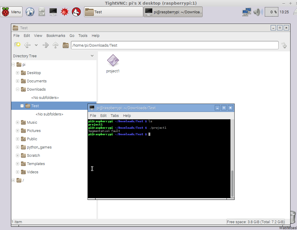

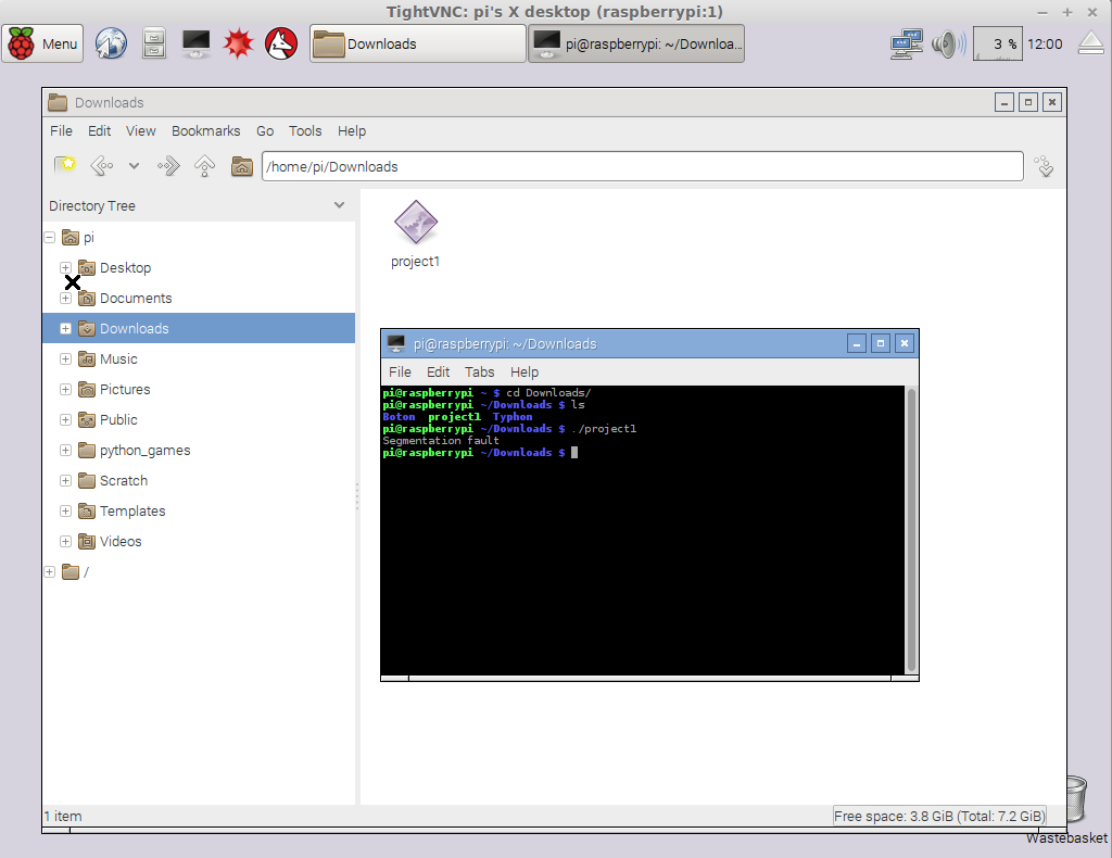

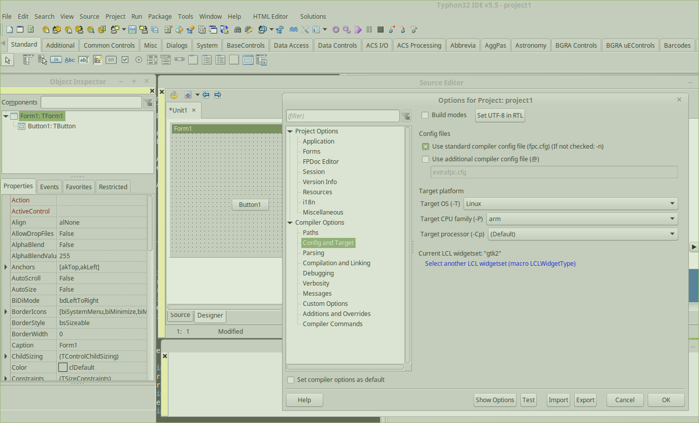

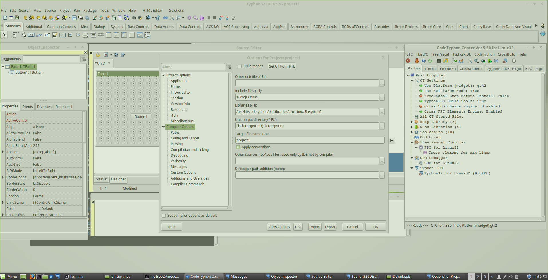

Im trying to build a program for my Raspberry Pi 2, all is OK except when a try to run the program in the Raspberry, i get "segment faul" message.
- Linux Mint 17.2 installed in VirtualBox version 4.3.18r96516
- Codetyphon 5.50 installed in Linux MInt 17.2 cinnamon 32 bits.
Can you help me please?
Thanks in advance!

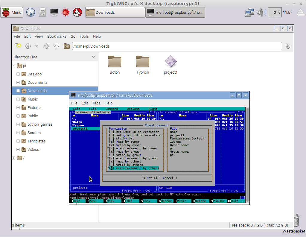

Raspberry Pi 2 Program "Segmentation fault" 11 years 1 month ago #8361

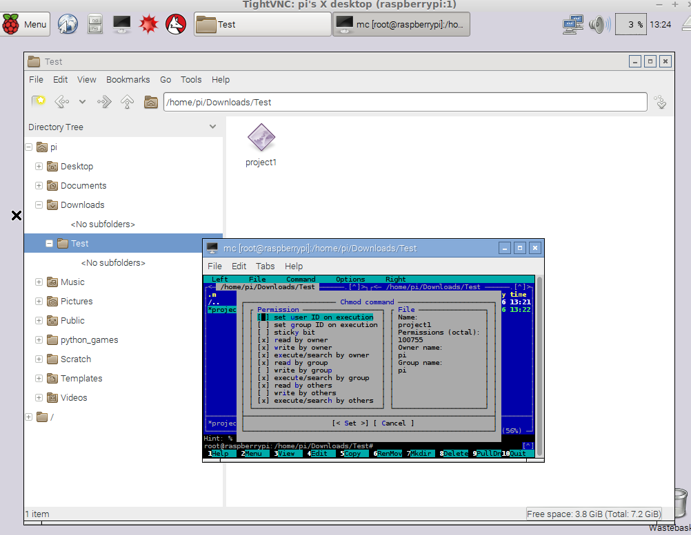

did you give executable permissions to your project ?
did you install GTK2 libraries to your Pi Box ?

Raspberry Pi 2 Program "Segmentation fault" 11 years 1 month ago #8363
  • Edox
  • Edox's Avatar Topic Author
  • Posts: 9
Thank you Mr. Stefanos for your reply
The first answer is yes, about the second, i install gtk2 in my Pi box with :
sudo apt-get update
sudo apt-get install libgtk2.0-dev.
But i get the same message "segmentation fault"

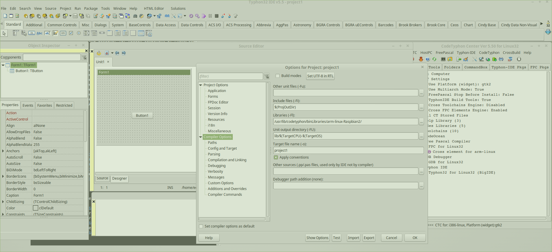

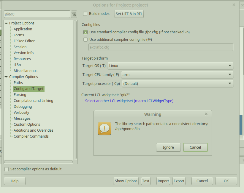

What Typhon packages do you in your Project ?

Mr. Stefanos
I installed according to the instructions gtk2.0, the installation was OK.
sudo apt-get install -y libgtk2.0
sudo apt-get install -y libgtkglext1
sudo apt-get install -y gtk2-engines-pixbuf
sudo apt-get install -y libcairo2
But get the same message when i run project1in my Pi Box.
About the second advice, I dont fully understand your question.
The program is only the form with a button
Raspberry Pi 2 Program "Segmentation fault" SOLVED 11 years 1 month ago #8377
  • Edox
  • Posts: 9
Many thanks for your help. The problem is solved but I dont know why this happen.
When I put the program in the Pi box using vsftpd and run it I get message "segmentation fault", but
when I put the program in the Pi box using Pendrive this run OK.
by last, when I compress the program and put in Pi box using vsftp, and then I decompress it in the Pi box it run OK. :huh:
