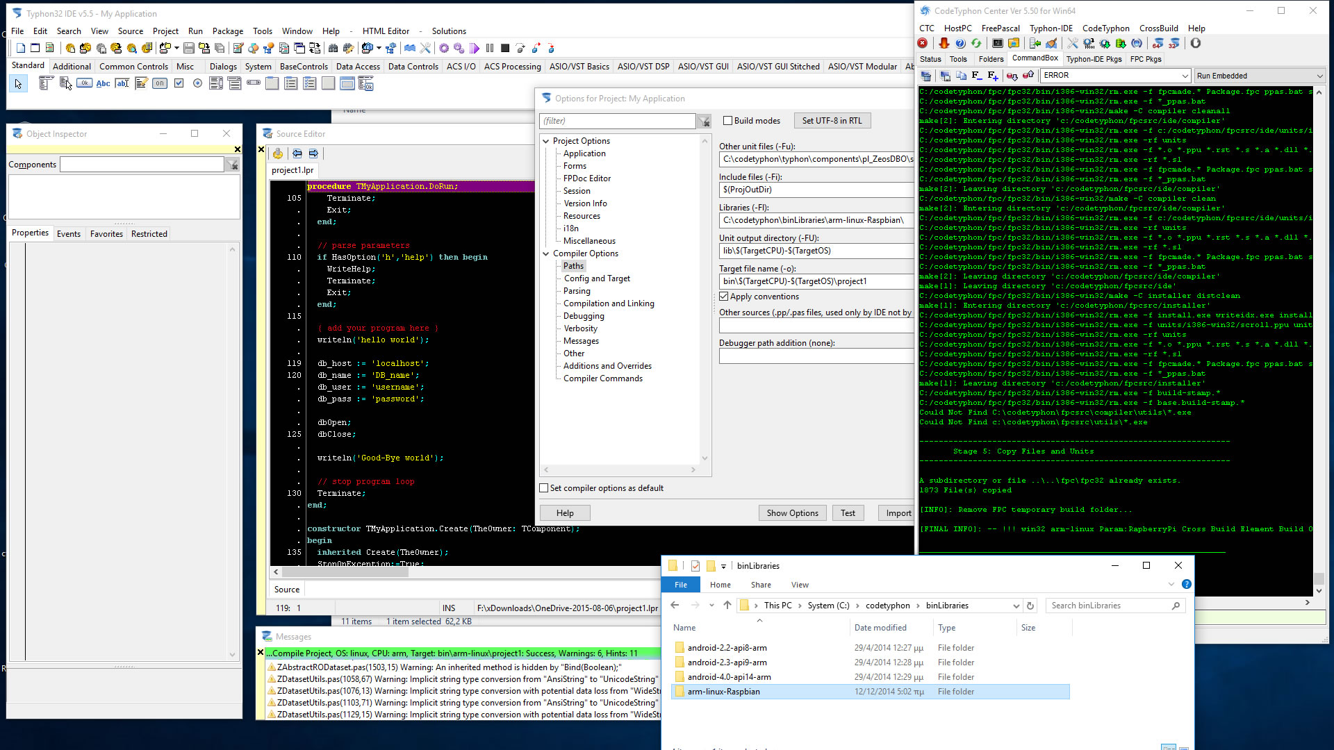

From within the IDE (using typhon32 not 64 on the Windows platform) i go into project options/Config and Target and change the target from default/default to linux/arm. I then go to Paths and set "libraries" to be c:\codetyphon\binlibraries\arm-linux-Raspbian and then perform a "run/build".

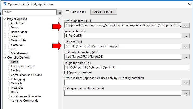

on Windows 10 (you must run CTCenter as Administrator) with Typhon32 we build your project (with no modifications)
without any problem.

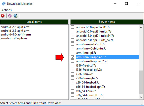

I thing you are using NOT correct OS-LIbraries for Raspberry Pi,
for our test we used arm-linux-Raspbian.7z OS-LIbrary file
Now My Suggestions for better Multi-OS project
you can use $(TyphonDir)/ IDE variable
$(TyphonDir)/components/pl_ZeosDBO/source/component/
$(TyphonDir)/components/pl_ZeosDBO/source/core/
$(TyphonDir)/components/pl_ZeosDBO/source/dbc/
$(TyphonDir)/components/pl_ZeosDBO/source/parsesql/
$(TyphonDir)/components/pl_ZeosDBO/source/plain/
and $(CTDIR)/ IDE Variable
$(CTDIR)/binLibraries/arm-linux-Raspbian/
