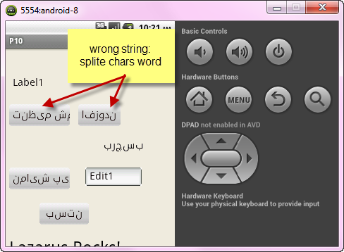

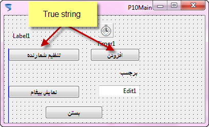

I want develop an application that must use arabic and persian languages. These languages are right to left and when I create android application with these chars wrong show these words.
I create a project and form's pic is:
But this application on emulator show like below pic:

Hello, did you try a higher api level? (I see you're using level 8 for android 2.2)

Hi
With API 14 and platform 4, this problem is solved; but a question:

Hello, for arabic/persian support in android 2.2 and lower you need to add some libraries (ilangoadigal.wordpress.com/2010/09/25/fu...2-2-froyo-and-guide/).
