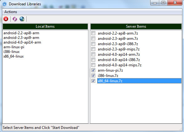

cross compile problems CodeTyphon 4.6 12 years 11 months ago #4785
Download the new libraries from our site Sir here
or use CTC/"download Libraries" dialog

thanks sternas!
work
arm-linux-pi
i386-linux
