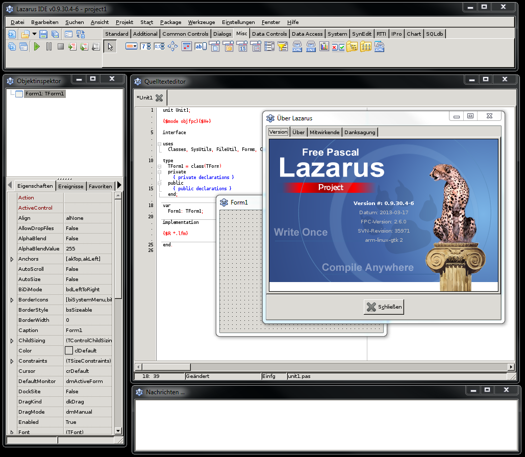

Here a picture of lazarus running on ARM Raspberry, using X-Forwarding (Xming 6.9.0.31) via SSH to display on Windows7:
Command line in SSH terminal is:
pi@raspberrypi ~ $ lazarus-ide &
