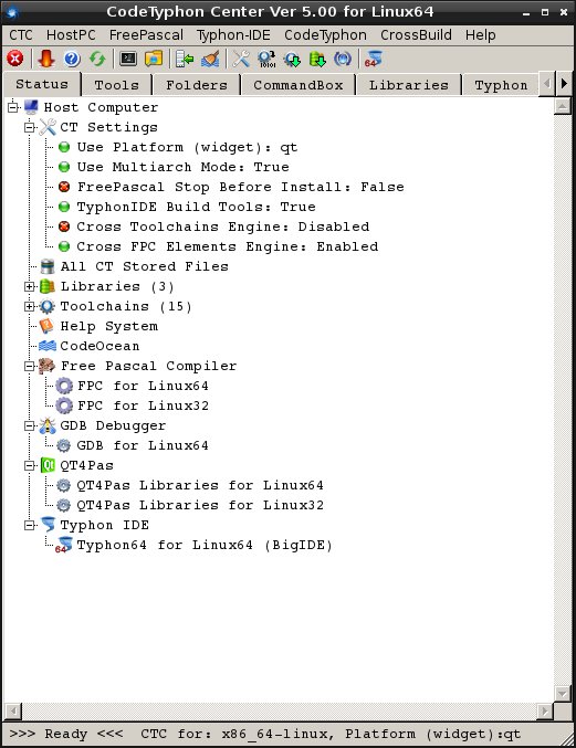

arm-linux raspberry pi 12 years 2 months ago #5890
  • zeljko
  • Posts: 207
  • Thank you received: 38
uninstal and install CT 4.92
upgrade to CT 5.0
Use QT4
install system libraries
remove and buidl Typhon
FPC64 build cross element All
download library arm-linux-pi
arm linux not work
Help!

arm-linux raspberry pi 12 years 2 months ago #5903
  • zeljko
  • Posts: 207
OK
3. Debian Family
(Debian, Ubuntu, Mint, Kali, WattOS, etc)
All executables stored in usr/bin directory
32bits libraries stored in /usr/lib/i386-linux-gnu
64bits libraries stored in /usr/lib/x86_64-linux-gnu
CodeTyphon MultiArch on this family is under exploration...
Last edit: by zeljko.
