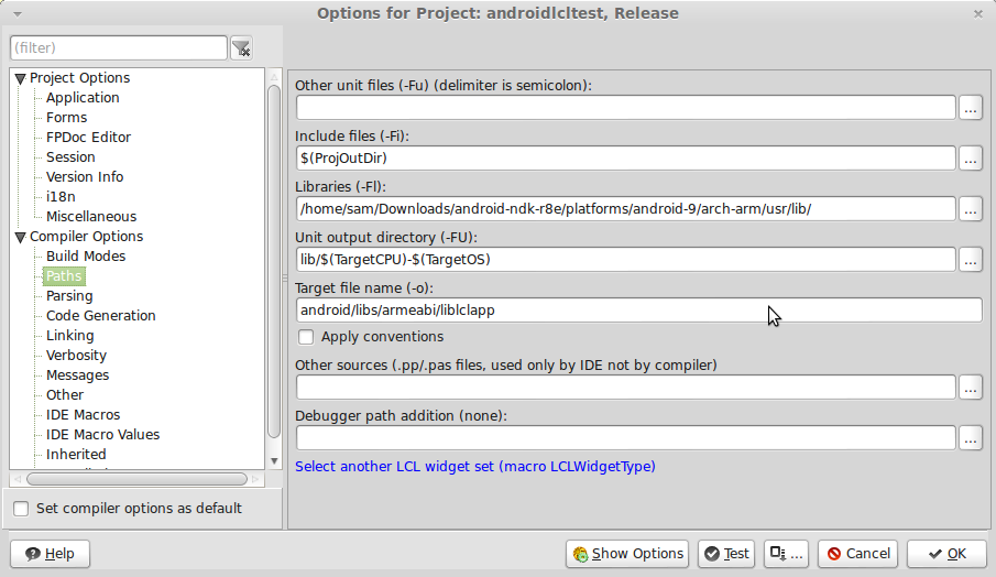

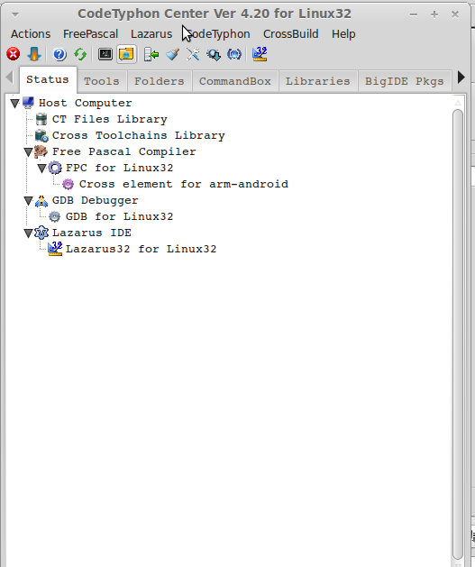

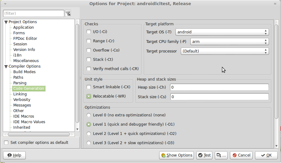

This is my current CodeTyphon setup:
This is are the project compiler settings of project androidlcltest.

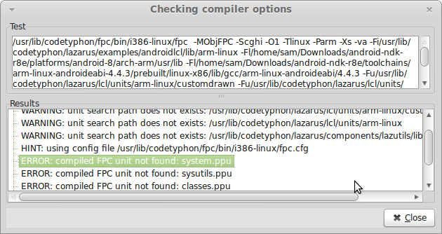

If I press button "Test" inside this dialog I get the following output:
WARNING: include search path does not exists: /usr/lib/codetyphon/lazarus/examples/androidlcl/lib/arm-linux
WARNING: unit search path does not exists: /usr/lib/codetyphon/lazarus/lcl/units/arm-linux/customdrawn
WARNING: unit search path does not exists: /usr/lib/codetyphon/lazarus/components/lazutils/lib/arm-linux
HINT: using config file /usr/lib/codetyphon/fpc/bin/i386-linux/fpc.cfg
ERROR: compiled FPC unit not found: system.ppu
ERROR: compiled FPC unit not found: sysutils.ppu
ERROR: compiled FPC unit not found: classes.ppu
ERROR: compiled FPC unit not found: avl_tree.ppu
ERROR: compiled FPC unit not found: zstream.ppu
Any hint what is wrong here?
Thank you.

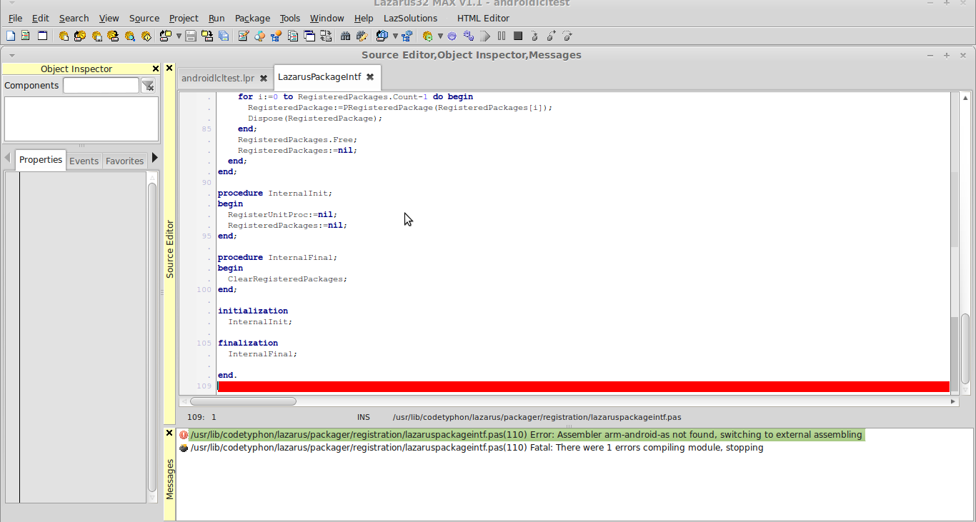

need help to compile android example. 13 years 6 months ago #3770
FreePascal 2.7.1 support native
arm-android
i386-android
mipsel-android
For arm-linux request:
arm-linux-androideabi-as
arm-linux-androideabi-id
Toolchain from Android NDK
The problem is that Lazarus request :
arm-android-as and
arm-android-id
one solution is to rename
arm-linux-androideabi-as and
to
arm-android-as and
arm-android-id
at /usr/lib/codetyphon/fpc/bin/i386-linux/
But, my suggestion is to wait for new CT version 4.30, we solve all these problems...

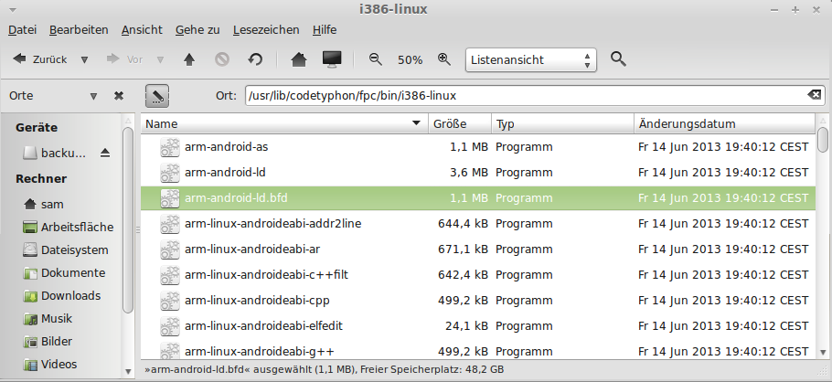

[Edit 02]: I had to rename /usr/lib/codetyphon/fpc/bin/i386-linux/arm-linux-androideabi-ld.bfd to arm-android-ld.bfd
Now I get: Projekt "androidlcltest" erfolgreich kompiliert. :)

need help to compile android example. 13 years 4 months ago #4280
  • Nicola Gorlandi
  • Nicola Gorlandi's Avatar
  • Posts: 2
You can found it in the android\libs\armeabi\ sub directory, the file is named liblclapp without extension.. (see in Project Option, path -o option)
