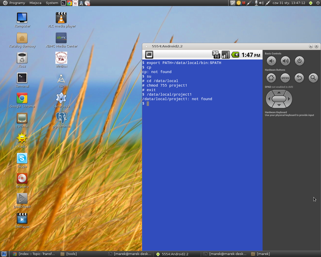

Hi
I'm trying to run application on android emulator. Lazarus compile project1 sucessfully but after this:
$ su
# cp /sdcard/project1 /data/local/project1
# cd /data/local
# chmod 755 project1
# exit
$ /data/local/project1
i got /data/local/project1: not found.
How to run it properly?
Last edit: by slot.

  • slot
  • slot's Avatar
  • Posts: 12
try
chmod 777 project1
the same result:
but thank you for advice
