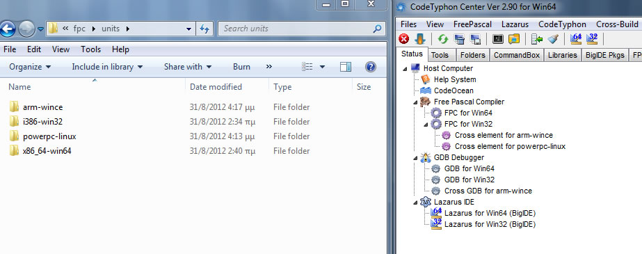

Here my report after complete delete and fresh install and fresh cross element, using CT-Center 2.80 32-bit only, also as admin.
The errors listed above occurred again in the same way, but the cross element again built successfully according to the last line of the logfile.
Well, have a nice weekend, as it works at least somehow. :)

Thanks for advices.
Running CT with admin rigths seemed to have solved the problem : perhaps could it have checked by CT, delivering a message !
Nevermind, the aim seems reached...
