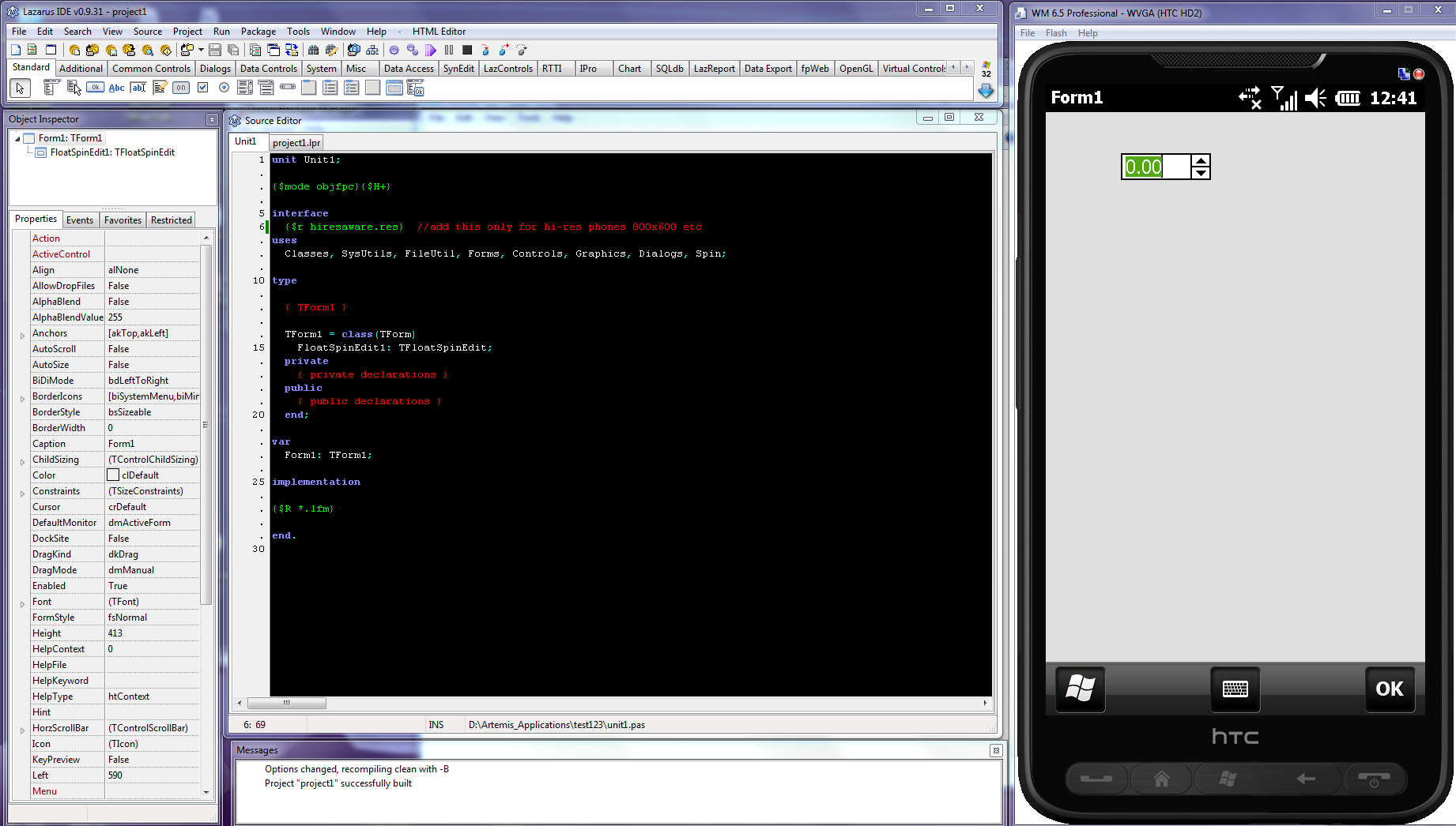

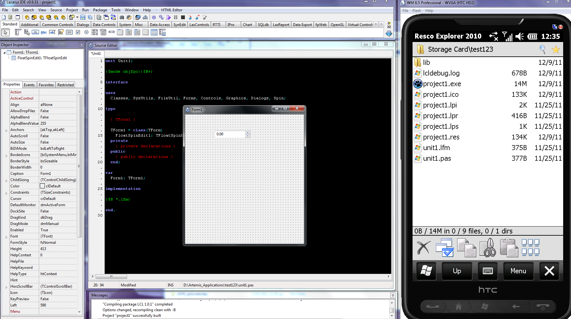

I have finished with a couple of tests here with Αλέκος program. Here are my results:
1. I have downloaded the provided project1.exe directly to my Omnia2 (WM 6.5) phone and i got errors for the message loop of the TSpinEdit.
2. I have lunched my CT 2.30 installation and RECOMPILED Αλέκος program. Downloaded to my Omnia2 and EVERYTHING worked perfect.
3. I did the same as above BUT including an .rc file for having the resolution of the program adjusted. The .rc files has one and
only directive: HI_RES_AWARE CEUX {1}. Also the program worked perfect.
The only thing i noticed is that the Lazarus IDE shows the following error: Compiler "c:\codetyphon\fpc\bin\i386-win32\fpc.exe" does not support
target arm-wince. But apart from that everything went ok.
Kostas

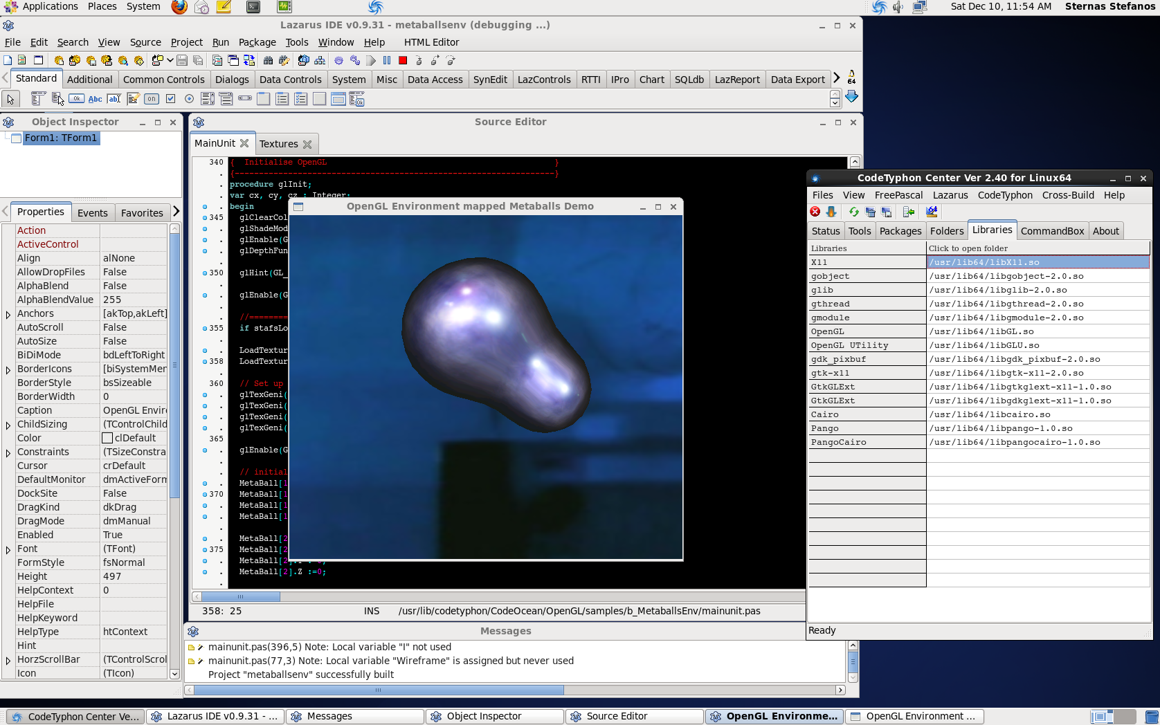

And a photo from the new version of CentOS 6.1 test

Kalimera Aleko,
I have tested your program with the Right Anchor set and indeed i got 3 - 4 error messages from the LCL complaining about
the message loops some windows messages concerning the change of position of the control. After all these message though it
worked correctly.
I also made a change in your program. Instead of applying the Right Anchor in Design time i have placed a button on the main
form and applied the Right Anchor during Runtime. It had the same result of error messages.
And there might be ANOTHER bug.... Setting in runtime the WIDTH of both the controls, they are also changing their LEFT property!!!
Instead of just grow, they MOVE too!
So Alekos, sorry for not testing your program properly the last time i wrote in this forum thread. I have attached the project and
the lcldebug.log that has been generated on my Omnia 2.
Kostas
