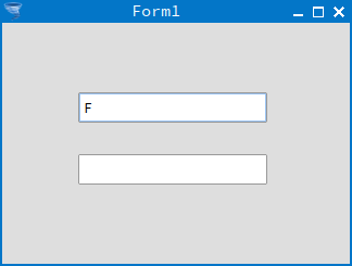

Hello everyone,
I have a problem with the TEdit Control, I use this control to enter the user and password.
The user can only enter certain characters, which is evaluated during the KeyPress event.
If the user entered a special character (like a German umlaut) then I don't get the correct ASCII code.
// special character
//ö = #246
//ä = #228
//ü = #252
//Ö = #214
//Ä = #196
//Ü = #220
//ß = #223
procedure TfrmLogIn.txtBenutzernameKeyPress(Sender: TObject; var Key: char);
  if Key = #13 then
    txtPasswort.SetFocus
  else if not (Key in [#8, ' ', '_', #246, #228, #252, #214, #196, #220, #223, 'a'..'z', 'A'..'Z', '0'..'9']) then
      Key := #0;
      Beep;
If I press 'ü' then I get '?' as Key = 63 '?'
Has anything fundamental changed here? This code worked without any problems about a year ago.
Thank you for your help.
Problem with TEdit 2 years 10 months ago #18103
  • Vbxler
  • Posts: 83
  • Thank you received: 5
I think I have found the solution,
I have to use procedure UTF8KeyPress instead of procedure KeyPress to be able to evaluate the special characters:
procedure TForm1.txtPasswortUTF8KeyPress(Sender: TObject; var UTF8Key: TUTF8Char);
var
  myKey   : char;
  myUTF8  : utf8string;
  myANSI  : ansistring;
  myUTF8  := utf8key;
  myANSI := lconvencoding.UTF8ToCP1252 (myUTF8);
  if (length(myANSI) = 1) then
    myKey := myANSI[1];
    if myKey = #13 then
       Application.MessageBox('Enter', '', 0)
    else if not (myKey in [#8, ' ', '_', #246, #228, #252, #214, #196, #220, #223, 'a'..'z', 'A'..'Z', '0'..'9']) then
        UTF8Key := #0;
        Beep;
